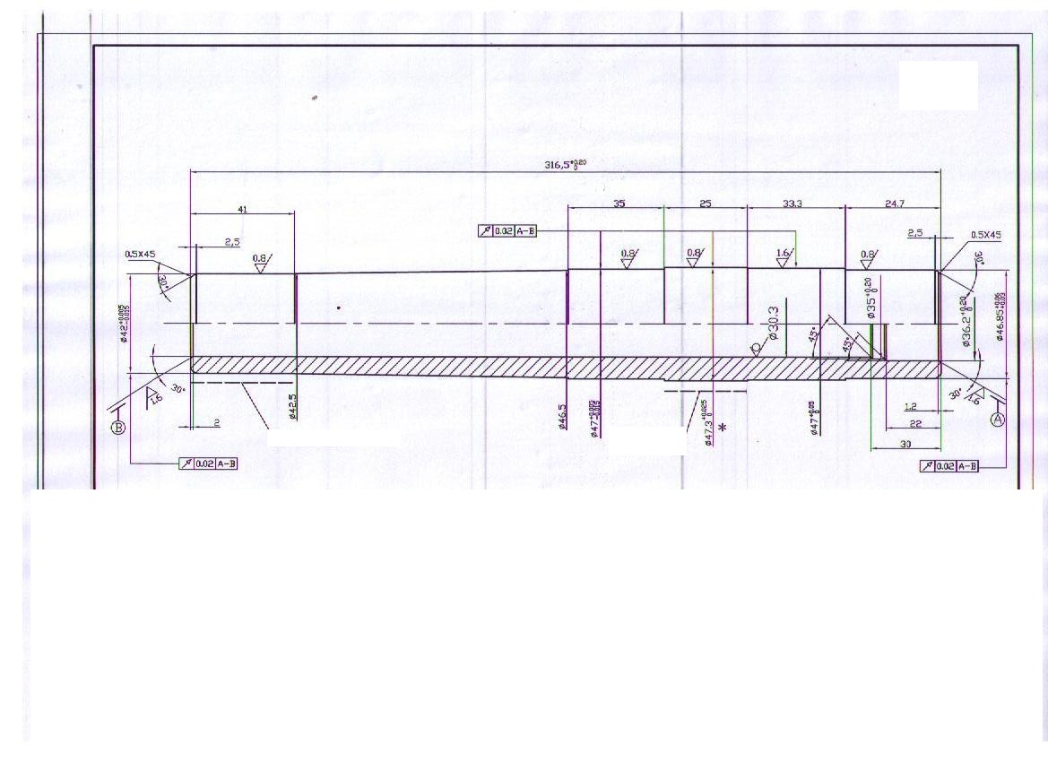

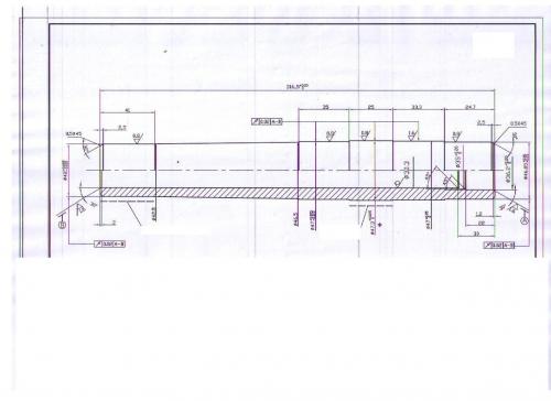

I have the technical drawings for the shafts somewhere, if it would help anyone?
I have no intention of supplying shafts/bearings anymore, before anyone asks.
Jimi
jimistdt
Here we are;
As far as I am aware these are the drawings to the original spec. No responsibility accepted for the outcome of any attempts to replicate or otherwise use the information on this drawing.
