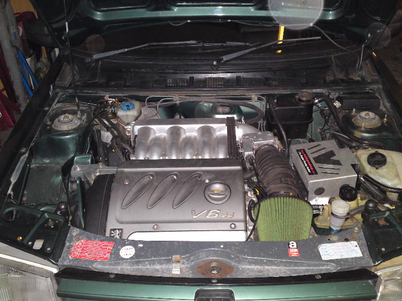

The same v6 engine in a 205 engine bay as a comparison
Bulkhead is the same, bit more on the inner wings and loads up front, Plus a cross member that's a box section and doesn;t wobble around like the 205 one
Agreed, IMO the distance between inner wings is definitely slightly larger, i can slip an engine & box in without removing battery tray without as much hassle as a 205.
The box section cross member on most of mine have been worse than 205's, but that's more to do with how rusty they've been! :lol:
