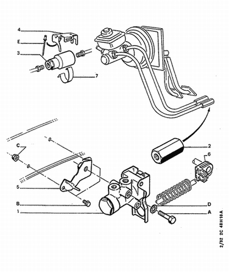

25ft it's enough for 1.6 or for 1.9? 1.9 has two pipe for rear brake, 1.6 has only one pipe with T piece. I'm doing this for 1.9 gti. I'm also need a rear compensator, because I had now a compensator from 1.6 and I would replace it with some compensator from 1.9. Where can i buy it?

I don't get something.
Part number 1, 2 and 3.
-Part 1 it's for 205 with abs
-Part 2 it's for 1.9
-Part 3 it's for 1.6 and another TU engine
It's ok? I have on my gti mounter brake kompenstor with number 3. I had also mounter front disc 283. I'm very disappointed with rear brake. It's maybe problem a compensator? It will be better if I mount some manual regulaotr of pressure?

I had find this:
the 1.9 uses 2 preset PRV's . a fixed pressure restriction. one on each line to the rear.
the 1.6 has one canister fixed on the n/s chassis leg at an angle. inside this canister is a ballbearing/piston arrangement which will roll forward as the braking force increases , shutting down the fluid to the single rear line. on a 1.6 if you load (or lower) the rear the angle of the canister increases thus giving more braking power to the rears . kind of a load compensator .
as stated there is no load compensation on the 1.9's
So I think it's better to use 1.9 compensator, because it had a fix relation of pressure.
(All pressures in Bar)
Pressure in / Pressure out
5 / 5
10 / 10
15 / 15
20 / 20
25 / 21
50 / 26
90 / 34
What you think? Or it's better to use a manual pressure regulator? :)
