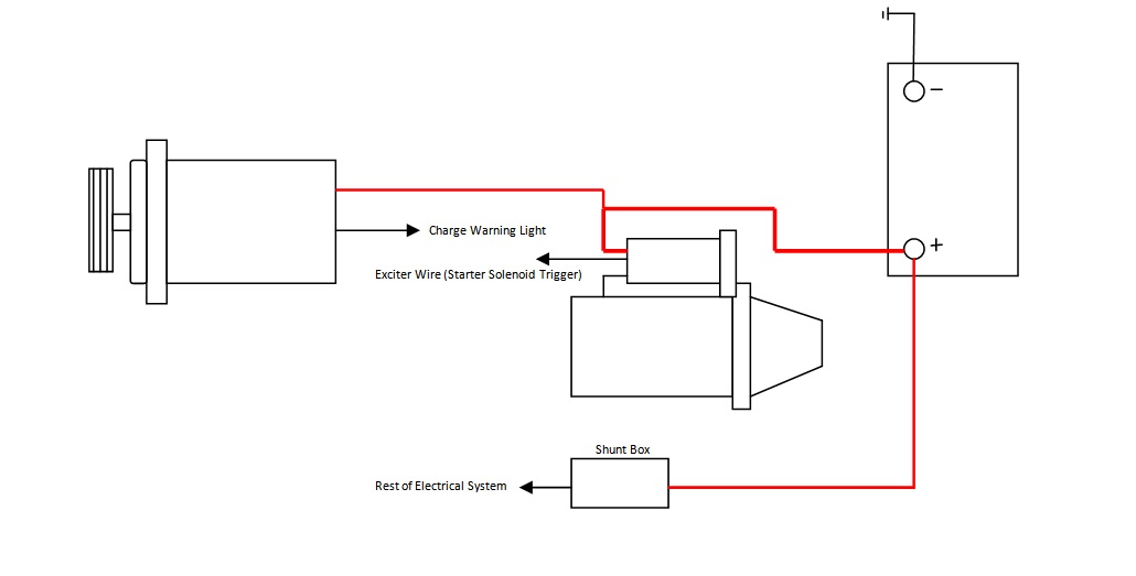

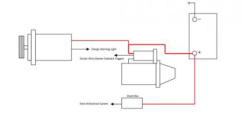

To Clarify what has been said I have knocked up this drawing to show how the main system is connected. It can be seen that thicker wire is needed from battery to starter, then slightly thinner from alternator and shunt box (maybe 16mm^2 / 110A to be on the safe side)
Steve

Thanks Steve, thats helped :)
