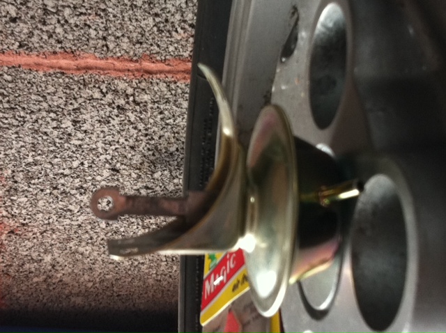

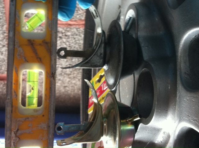

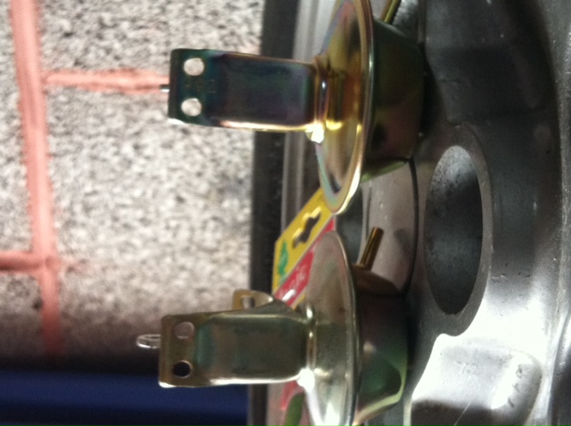

just an update on the vac advance units i purchased from the states they are for vw/audi L4 engines fitted to old golfs,sciroccos etc bosch number 1237122447.
they cost £34 for 2 delivered and are perfect fit for the 1.6 one the critical part being arm length is the same,only difference is the vac inlet is thinner than pug one and slightly different position,a new section of vac hose sorted it out.
1.9 ones have a slightly longer arm so i just cut my old one part of the way down and then cut new one slightly higher and then tacked together with the mig and it works perfectly now.
the 1.9 is apparently still available but the 1.6 is now obsolete so the VW one is a viable alternative in my opinion.
apologies for the pictures being 90 degrees out they were taken on iphone and for some reason always turn out that way when uploading.
picture 1 modified for 1.9 advance is on left compared to a 1.6 one
picture 2 shows where i cut and welded
picture 3 is vw advance on left original pug is on the right.
