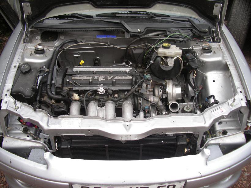

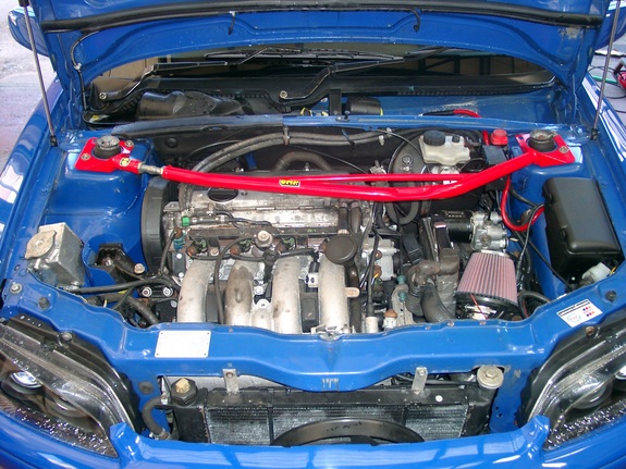

post-3457-0-60866800-1301009749_thumb.jpg post-3457-0-31314200-1301009754_thumb.jpg
A couple of examples
