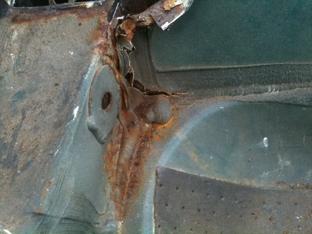

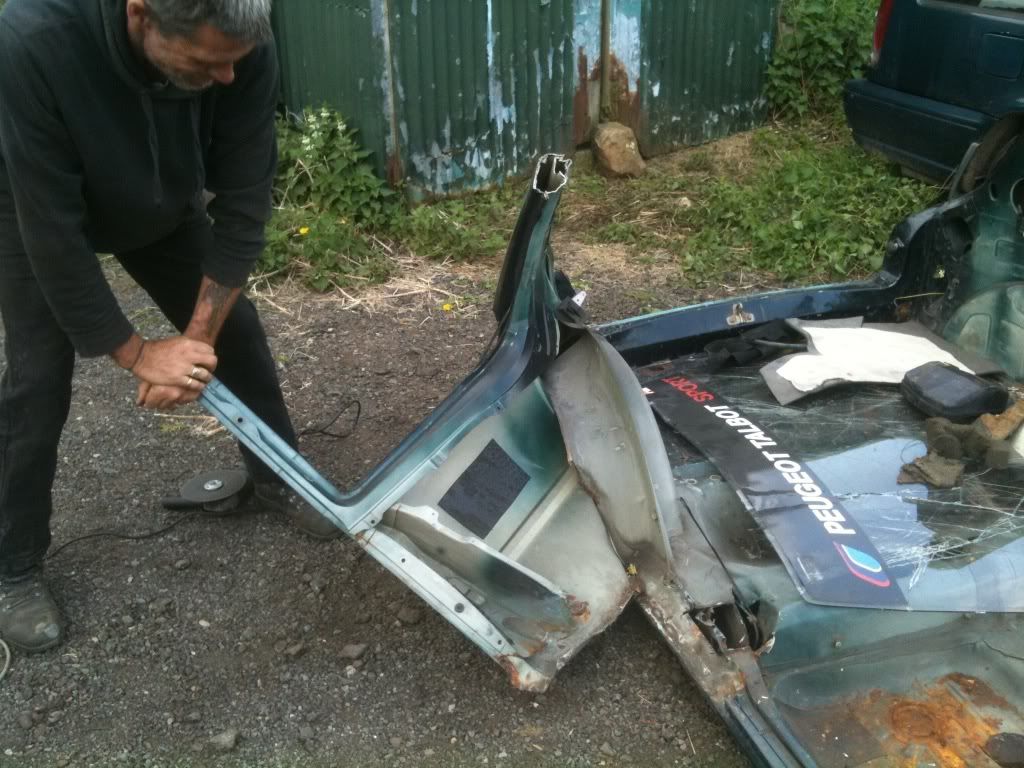

OOJ has now gone, i cut the roof and a few other parts worth saving off her, but whilst doing so, it became actually how apparent how absolutely f*cked the shell was, it started splitting along the seam between the floor pan and rear-seat section;
And yes the rigidity is mostly in the roof, but the rear quarters literally peeled away from the floor pans/sill alarmingly easily.

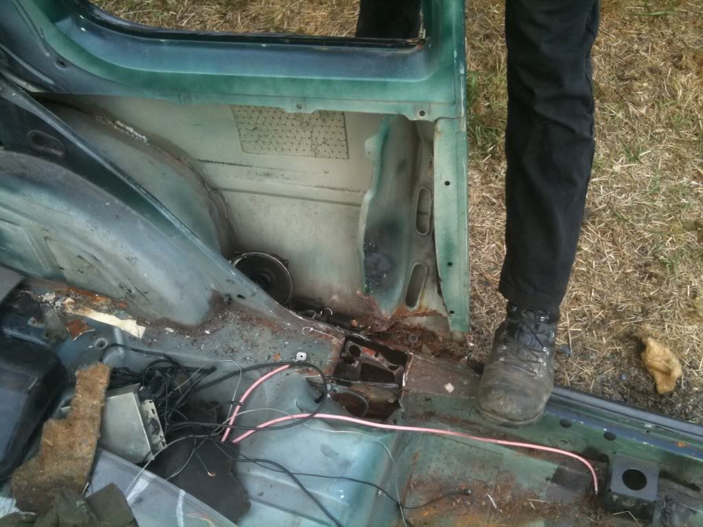

The seat mounts... thank whatever lord you like i didn't have an accident in the thing, again serving as what shouldn't be needed to me anyway of yet another reminder to pull the carpet up on ALL these cars and check them, they crack, rust and disintegrate at an alarming rate;

I'm not surprised the rear quarters peeled away so easily. My graphite shell had split it's spot welds on both sides and both quarters were loose. You could put a finger in and pull the panel away, and when I was inside the stripped shell I could see the road underneath when looking down.

Nothing's really surprised me tbh, i could put about three fingers up into the inner sill next to the tank into the box section, the rear towing eye's been m issing for years since Ben/James_R tried to tow something with it, it just pulled straight off!! Strangely though, the bumper mounting and square section above it was mint on the same side!
Thinking about it, it reminds me of the Wheeler Dealer's shed, you could get a few fingers inside the car where the seam had rotten away between the bulkhead and floor pan, and a finger in a hole above the rear quarter window! That one had gone in really odd places!! :lol:
