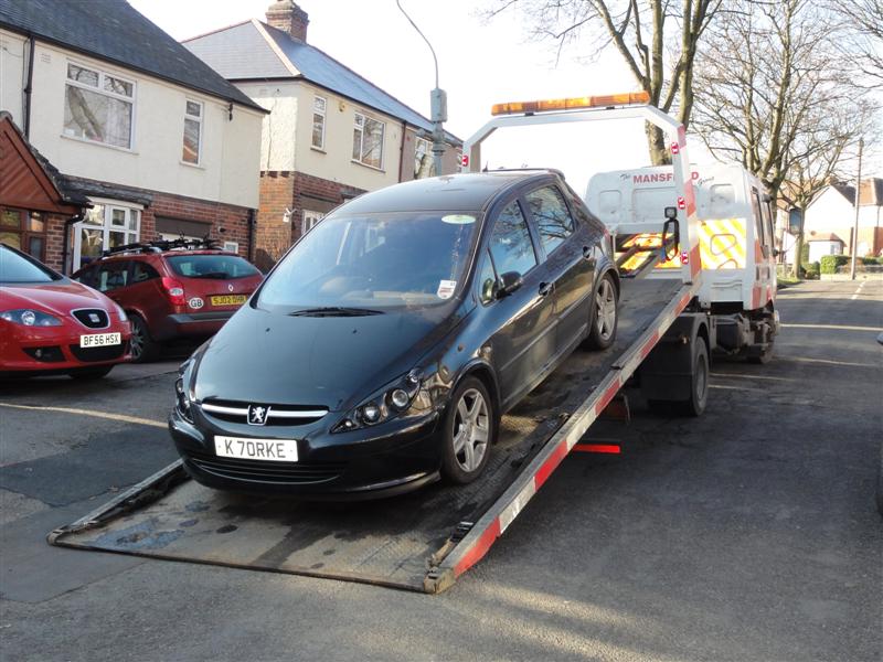

Update. I whipped the crank sensor out and it looked ok with no bites out of it though a slight scuffed area on the face, but there was no resistance across it on a multimeter. Neither Peugeot or Citroen in Sheffield had one in stock today, so I took the lazy option and had it trailered off to my brothers to go and work his magic on it. I pay breakdown so I may as well use it and he was able to get one ordered and delivered for when the car arrived B) I was thinking about M@tts long running MG saga and I need the car back on the road asap or I will re-tax the skip.

I realised after the recovery truck was on its way that I could have probably got one from GSF / ECP, but they would have been shut by the time I got there. Peugeot said order today for Wednesday delivery and they were a bespoke part that only they sold!
