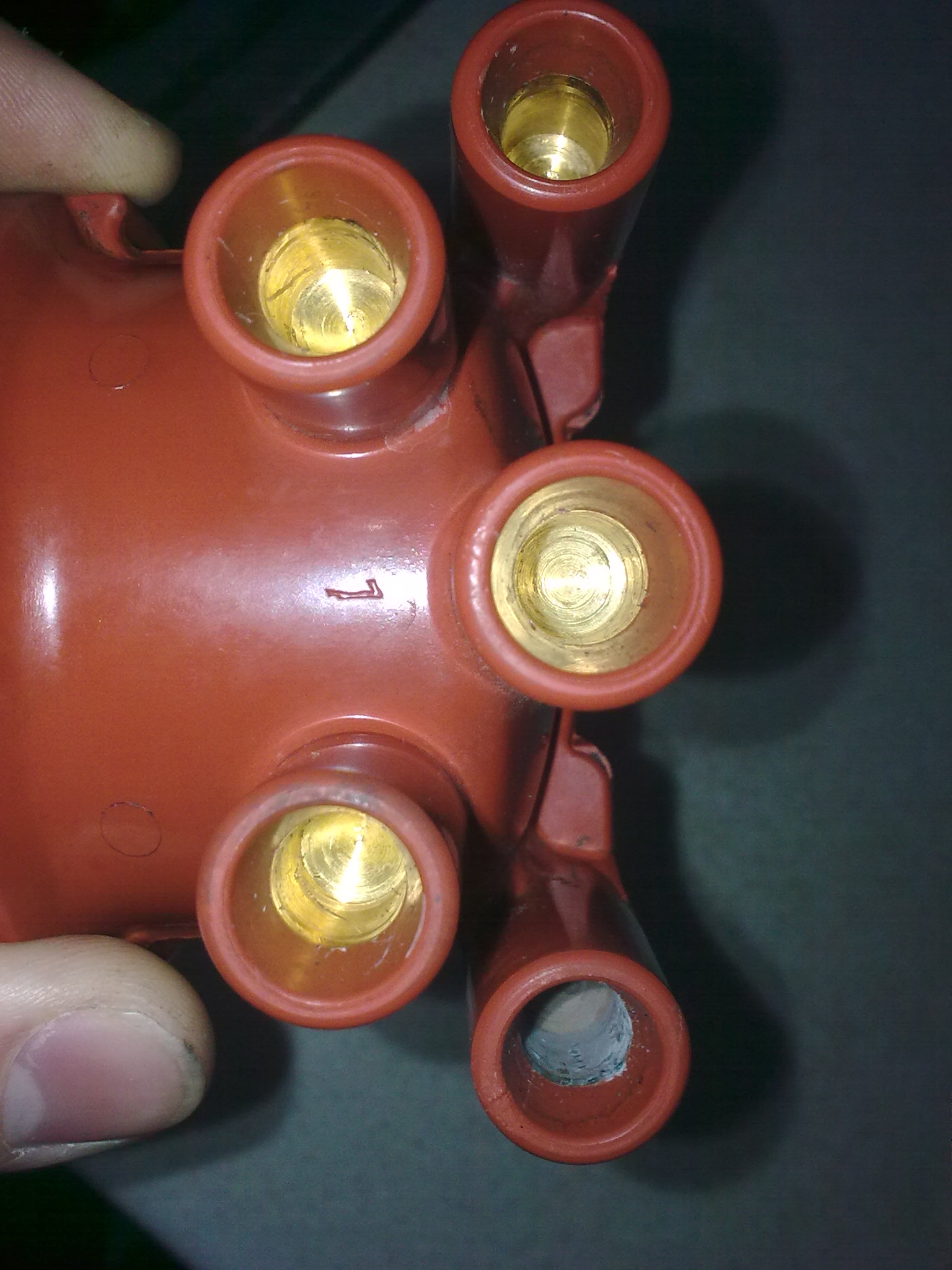

May have found out why I've been suffering the misfire and bad starting. One of the terminals inside of the dizzy cap was looking a bit worse for wear. Replaced the cap and so far so good.... I'm hoping that's it sorted *everything crossed*
