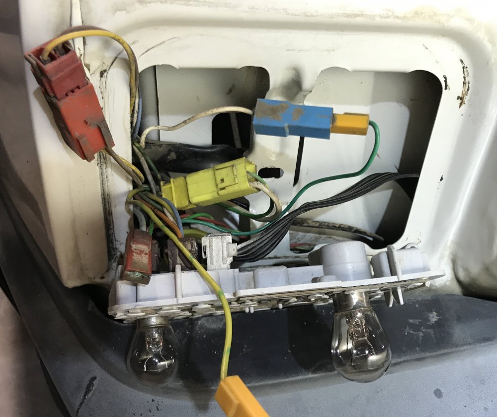

Both sides of my rear lights clusters do not work (205gti). i.e. reverse light, indicators, park lights etc.
Searched and could not find anything obvious. Checked wires as far as I can see and changed globes, checked fuses, rear grounding point.
Front main lights (headlamp, high beam, side lamps), front indicators work
Any help greatly appreciated. Have access to a multimeter if required.
Wiring as follows.

LHS Passenger side
LHSrearclusterwiring.thumb.jpg.1c35b1bf28286e2d49bcf7bf1f59f24d.jpgLHSrearclusterwiring2.thumb.jpg.fdcbf5dff625657439873ada66bb368c.jpg

48 minutes ago, jj007205 said:
*There is a single ‘tab’ at the back of each housing. IS there something that needs to connect to this?
Yes ! , an earth .
That'll be the yellow/green wire with yellow single spade connector .. so you're missing earth on both sides .
Power feed goes from the fuse box to the LHS unit only , then the RHS unit uses power supply taken from the LHS unit via that black cable which connects the two of them .

With the earth, pardon ignorance; does one need another on the RHS too? There is no yellow/green wire on the RHS.
Just the LHS , when there's power and ground present on the LHS unit the RHS one will take both feeds from it for it to work .
Wasn't sure either just looked up on the wiring diagram .
D
