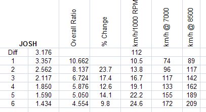

50 quid seems very cheap to me, but I have no idea of the market value in the UK. I'd flog it for a profit. Why not just start with the standard 1.9L box? There's really only two things to worry about, the overall ratio and the % change.
The overall ratio equals gear ratio x cwp ratio.
ie for 1.9L 1st gear
2.92 x 3.62 = 10.58:1
If you go any higher than that (lower number), you'll find it difficult to get the car off the mark. The turbo isn't moving so you're relying on the torque of the unblown engine.
% Change
This is the difference between two gears.
ie for 1.9L 3rd and 4th:
(1.036-1.069)/1.036 X 100 = 21.4%
As you move through the gears the gap should get narrower (smaller numbers). Cars with narrow torque bands need closer, cars with wider torque bands can be larger. Thus all the debate above. Once you get a an 8V turbo off the mark and the turbo spinning it can easily pull wider ratios and a longer 5th gear. Thus you might find an Mi16 set of ratios with a taller cwp(smaller number) is ideal for you. eg 3.94:1 or 3.62:1
Or even more simple, a 5spd from an 8V 1.9L or 2L 405.
Hope that helps!
