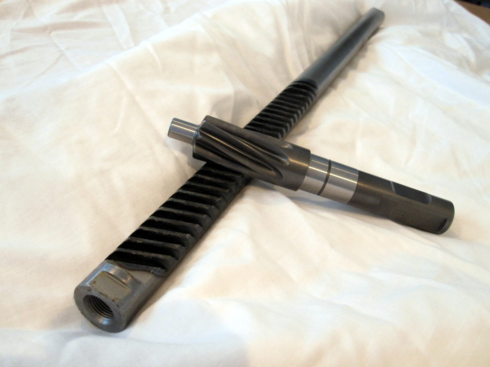

Ok, here's a photo of the Quaife parts:
That looks like its the splined type ?

It won't work. If the LHD rack is a mirror image or the RHD rack then when you flip the rack the teeth will go diagonally the other way. The pinion will be still coming downwards and now the teeth are completely the wrong direction to mesh. If the teech on the rack and pinion were vertical then yes it would work but they're nearly 45 degrees.
I can't see any splines? If you look at the top of the pinion you can see the flat points, making it the square type.

Right i see what you mean, im getting confused about the pinion 'cogs' being the flat square type like the pic in the link i posted up, not the curved cog links like your photo.

hmm....you rotate a rack for 180 degreese (if you look in direction of teeth)......so the angle of teeth on a rack stay at the same angle than before.....or not?
If everything it same (symetric) then it can work....
No, as i say if you rotate it through 180 degrees as it would be for your rack as the pinion is at the other end the teeth on the rack would then be sloping the wrong way on your rack. As the pinion is still going through the top of the rack casing and facing downward still it won't mesh at all. The only thing you can reverse is the rack itself so the teeth no longer work as it's not straight cut.

Surgie, i think you are a little confused. On your photo all you can see the top part of the pinion that sticks out from the rack casing. This is the only bit that differs, one is splined and the other is flat. Both mine and yours are flat (square). It's just in my photo you can see the actual pinion teeth and the rack itself.
