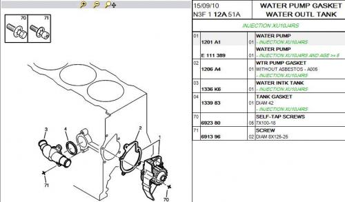

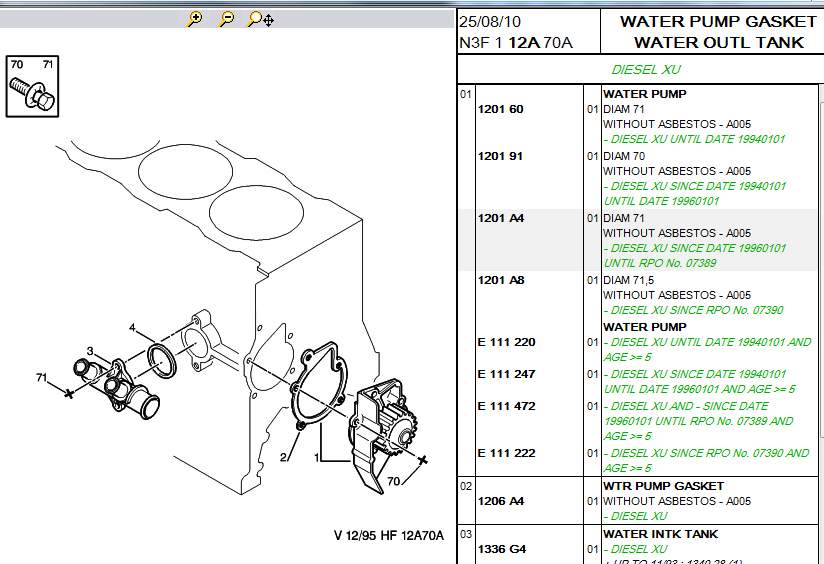

I'm pretty sure that's the wrong thermostat housing - 306 GTi-6 ones have two outlets on the back, whereas 406/Xantia 1.8/2.0 ones only have a single outlet like you've got. You need the additional outlet to connect to one of the heater matrix pipes, whereas the other connects to the black pipe that runs across the back of the block.

Right-o then. Looks like i defo have the gti6 water outlet fitting. And looks like i do need the Diesel XU/S16 one as i originaly thought! Which means ditching the black pipe completley.

As said, it's the thermostat housing that looks wrong to me as it should have two outlets rather than the one that you have - hopefully someone with a GTi-6 engine can confirm this.

As said you have the wrong housing, the 6 one has 2 outlets at the back and a very short joining pipe to the black pipe to the Dist (Water Tank) at the back of the engine,
I'd keep the 6 setup as the water pipes get very close to the exhaust otherwise

Ah! the only one i can find like that is the one from a D-Turbo but it looks like it has the same fitting for the black metal pipe and the two for the heater hoses.
