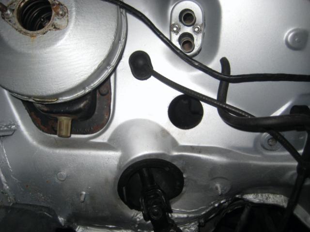

Pinched this pic from smokey's classic named title "what goes in this hole?" hope you dont mind .
In the pic you can see the bulkhead heater top and bottom outlets.
