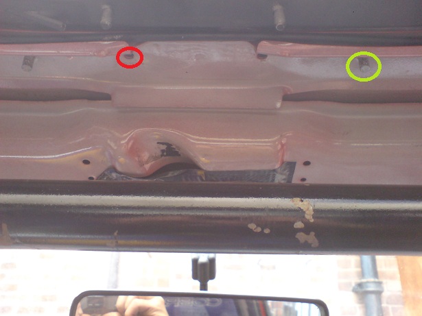

205*31* 0 Posted July 23, 2010 ok I have took a picture the hole circled red is where I presume these philips screws were in and the bit I circled green are all these rivet nuts they are all round inside. So if the 2 philips screws are already out I guess the front trim should be lose... so how does it pull of from outside? also these other 2 screws you mention on the sides are these underneath the front trim so once removed you will see the other 2 screws on outside? cheers. Share this post Link to post Share on other sites
Rob Turbo 3 Posted July 23, 2010 The phillips screws are the ones that hold the front trim on, with them out, open the sunroof and hit the trim forwards with the palm of your hand, it's probably nicely stuck in place by now, once the front is off take the torx bolts out of the side trims then slide the trims back then pull them off, now you will be able to see the stops at the back end of the guides, remove these and the sunroof handle, the glass will now slide right back out of the guides. Make sure everything is disconnected from the mechanism (drain pipes and vaccumn pipes and possibly operating cables, I can't remember exactly what's on!) then remove the rest of the torx bolts from outside and pull the whole lot out, it's also stuck down so be careful not to damage the roof. Share this post Link to post Share on other sites
