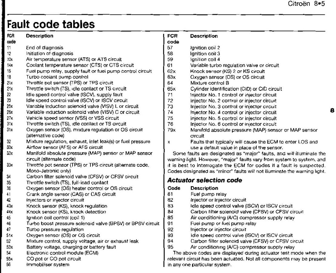

ECU (204839, Bosch Motronic MP3.2) => 27. ... Unfortunately I couldn't find a document revealing its meaning. Bye Dandu
vehicle speed sensor.
Dandu
Much thanks, welshpug. Do you have a reliable list of all fault codes? Google and co. come up with different explanations for fault code "27".
As far as I know, the vehicle speed sensor can't stay in relation with my current problem. Hmmm. ... Perhaps it's an old fault code. Today I'll delete the fault codes, drive around and check them again.
Cheers Dandu
if its like the gti6 and s16 ecu's they give drivability issues such as flatspots and stalling, so its quite possible that it is contributing to your issues, especially if the ecu has an overboost facility.
Jamal
VSS is needed for the proper boost/overboost.
VSS fault was one of my problems. The other was te ECU's temp sensor. After fixing these problems, the car flies now :huh:
Edited by Jamal
there you go, confirmed my thoughts :huh:
most of the codes are generic so would be the same across a lot of cars, what came before OBDII.
