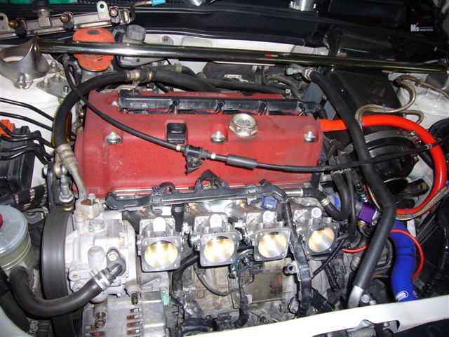

Can Anyone Tell Me What Is Going On Here.
sideways danny
AWESOME!!!!!
K20a is a fantastic engine, they supercharge VERY well too. Quite easy to get them to 300bhp on completely standard internals with a Rotrex
Is this engine longer or shorter than an XU? In other words how much inner wing clearance is there on the cambelt end? Its not easy to see in those pics.

The engine has plenty space on the cambelt side. For reference look at your 8 valve top mount and it falls 1/2 inch away from the two bolts that are in line.

Any more pictures of the fabricated mounts, gearbox welding?

What are the ratios like on the Peugeot sport gearbox? Your going to need something really low geared to work with 8500 rpm+?

Hey Bally
Have you got any more pictures of your mounts?
I'm really interested in trying this myself and being a rank amateur could do with all the help I can get.

the k20a also goes well with the jenvey 50mm throttle bodies (but not with a/c because jenvey's inlet didn't offset for the compressor).
