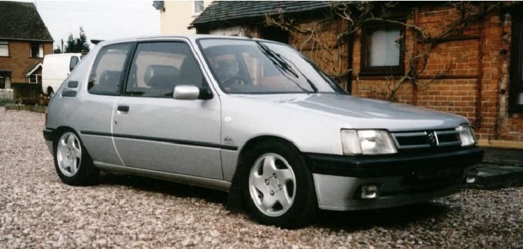

GeorgeXS
Hopefully a bit of inspiration for you!

Nice XS George! B)
The Arch Bishop
That looks goooood! I'll second that!

My old XS. I think the 306 DTurbo wheels look great on a base model and are cheap enough now
Henry you rude boy............
Lan
george that xs looks great certainly puts my tatty looking one to shame
