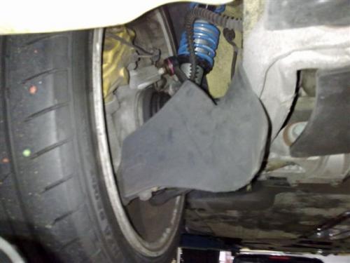

Such as:
Can't think how you'd attach it to the wishbone though :)

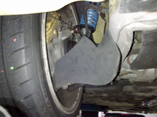

doesn't the 206 use something like this?
SurGie
Would there be a problem with rain and water going through to the disks ?

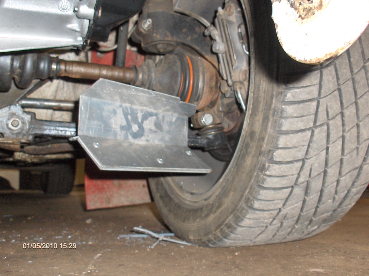

this is what i have come up with

Do they work though? :P
RossD
Looks interesting Jimmer - What calipers are you using there?
jimmer
PTS alcon 4 pots
engine killer
Do they work though? :huh:
I think so. I have seen quite a number of Porsches (944,968 and 911) have this kind of duct/flap in front of their front wishbones.
harryskid
I like the idea but i would be worried if i tried them on my rally car. I mean would they be a bit vulnerable on uneven surfaces?

jimmer
i did think that myself when making these, on sealed surfaces i think they should be ok. When you get into realy looking what will work on a 205 its bit of an engineering nightmare, with the drive shaft and brake calliper in front of the hub there really isn't much room, i can't see how anything else will work. I have looked at the proper ducting method and there is very little room for a outlet duct on to the centre of the disc, couple that with a good steering lock on a 205 (which is definatly needed for sealed surface chicanes) compared to some circuit/track cars that could loose some lock and free up space for more complex ducting. I'm doing some testing next week on Keevil airfield so i will report back to see if they work!

This is the one I found in a Porsche 993 Turbo S

After a track day at Keevil last monday with a fairly high speed circuit the brakes performed really well, No hick-ups at all, even with a lot of left foot braking. I could stop in a third of the distance of an evo 6. Back in the pits after the laps my disc temps were around 200 degrees celcius, which was around half of my mates evo. Whether the air duct fitted made a big differance i don't really know, but on a fastish circuit/stage i think it can only help.
harryskid
I assume you were on the main track, not the rough narrow bit we used last year on the Fat Albert? Also are you doing The Three Counties as we could have a chat? :lol:
jimmer
I assume you were on the main track, not the rough narrow bit we used last year on the Fat Albert? Also are you doing The Three Counties as we could have a chat? :)
yeah i've just entered 3 counties stages, hopefully i'll get my first finish for 3 events.
