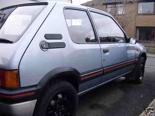

dave_6785
mine feels nippy as hell with em on anway, 2nd gear gets to 55mph without worries and gets there around 10 seconds, top speed is over 95 which will do and its only got a full decat with big bore exhaust and a pipercross induction as performance mods. looking at stickin a 1.4 from a GR or XS & dropping the front on a 1.9gti set up with uprated brakes and a strut brace. I'd rather do all this to my car than use the money to buy a GTI. Daft maybe but the car deseves it lol
http://s829.photobucket.com/albums/zz214/D...pg&newest=1
