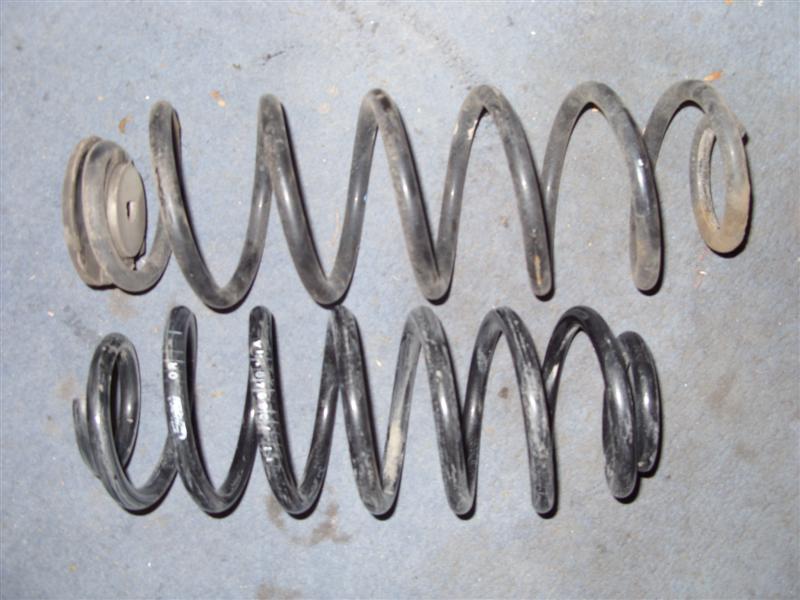

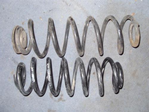

Tonight I lowered my 307 HDI on a set of Eibach springs. It was a really easy job to do compared to a 205 as the struts bolt on as opposed to sit in a hub which you have to prise out.
The Eibach springs are quite a bit shorter than the originals and seem to be made of a much denser metal as they heavier by comparison,

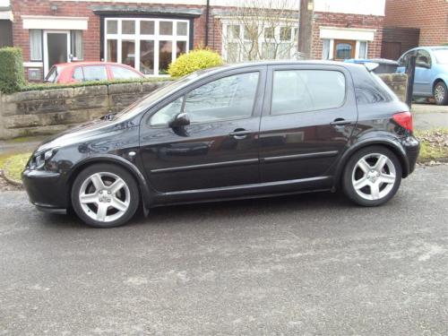

Aesthetically the car does not appear much different with a 30-35mm drop, as the 307 rides quite high as standard.

Pics.
Not a huge drop which is what I wanted. You can get 50mm+ ones but I wanted to improve the handling and wasn't too fussed on the aesthetics. The arches that are on it make the whole wheel arch look bigger than standard.
Probably just a bit wider on the wire diameter, wire length will be somewhat similar given they have the same number of coils.
