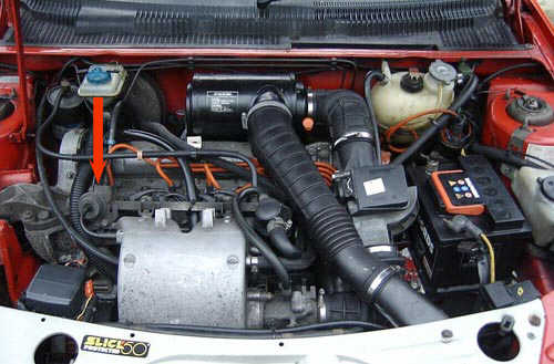

Quick question, I am trying to source an exhaust and I need to know my engine type. I'm led to believe it is a 1.9 in a 1.6 car and I know it is stamped somewhere on it but does anyone have a quick photo of where so that I can establish it once and for all?
There should be a small silver plate with a black box on the top of the block by the r/h upper engine mount next to the front of the cylinder head but they are known to fall off.
Roughly somewhere around the area indicatd by the arrow;
Your looking for a three digit code, which for a 1.9 should be D6B if you have a 1.9 engine fitted.

Thanks Graham, I suspect mine has broken off in the past. Is it stamped on the cylinder head or elsewher on the block. And what engine type does D6B then equate to? XU9JA, XU9J1 or XU9JAZ (or is there any difference)?

D6B equates to the XU9JA, the others will all have a different engine code as shown in the links etc Rich posted.
Unfortunaterly the engine id (not engine number, thats on a seperate plate next to this one) isn't stamped anywhere else on the block or head & simply having yellow injectors isn't a sure fire way to prove you have a 1.9 engine.
