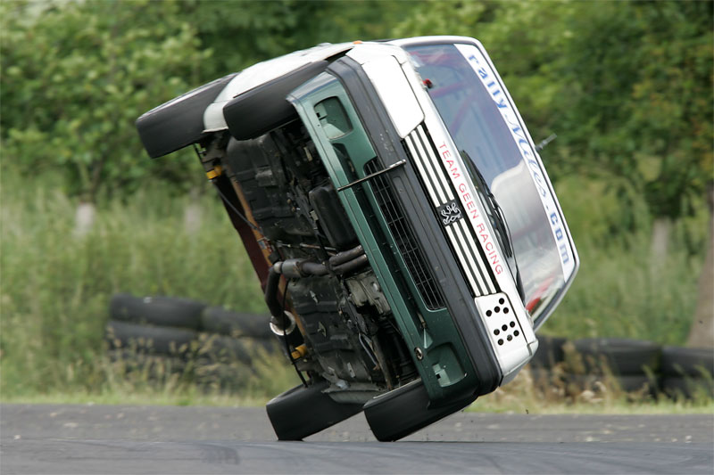

In 04 when I took my rallye on a trackday I could get it on two wheels round the chicane at Bruntingthorpe with 1.9 alloys and road tyres without touching the kerb. With AO48's I've only used them with proper suspension..

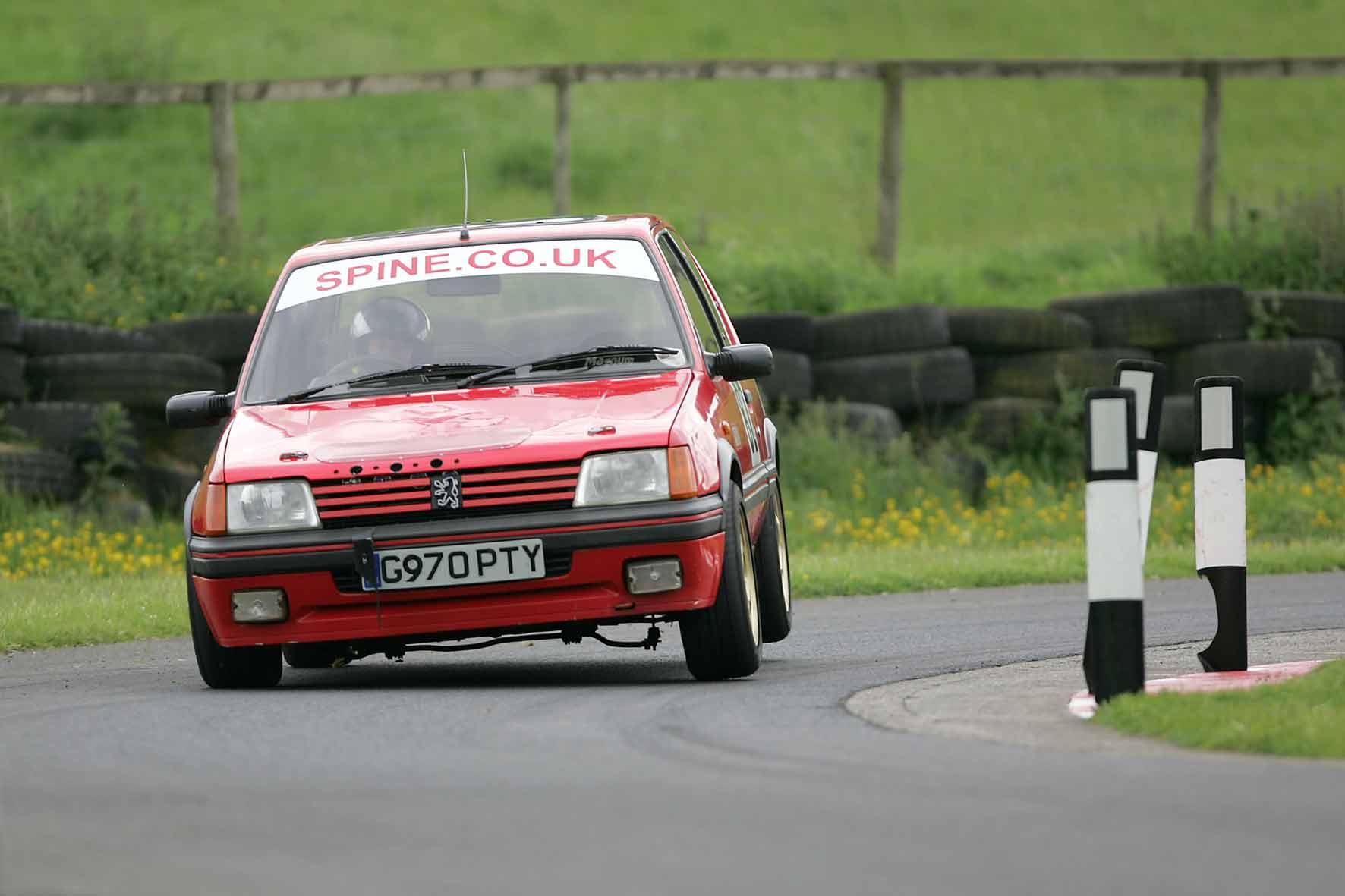

Why are you guys obsessed with if a 205 will roll or not on flat ground ???....Im sure the original post was just about how the car was handling & what people thought.....any chance you could make some reasonable suggestions ???
To me, it definitely looks as though it needs better suspension as there is quite a bit of body roll.

I would simply say that from being involved in sprint/hillclimb racing and watching many rolls - that if you are using a road tyre and try to corner too hard or you catch a kerb, typically the road tyre generally loses traction and the car may cock a wheel but simply slides wide. With a sticky tyre there is a real good chance that the tyre will 'dig in' and put you well onto two wheels or worse
Road tyres sliding :-
Stickies digging in
