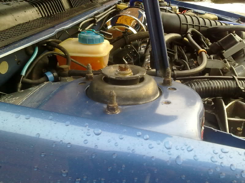

Ive notice under my bonnet that my strut top are sitting high between the top mount and the washer/spacer.(see Pic)
Ive got new B4 bilstein dampers coming and got new grp N rubber mounts and bearings
Just wanted to know what causes this to happen and should i repalce any other part?
Also if you look at my ride height at the front once ive fitted the grp N mounts ive heard that they will raise the height by approx 10mm?
How long does that last? do they relax over time sinking down or will i need to get some 20mm lowering springs to bring it back down?

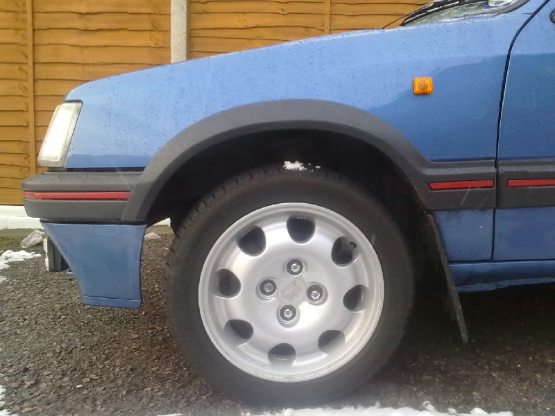

At the moment the ride height is 75mm between the top of the tire (195-50s) see pic.

that doesnt look right at all, especially with new rubbers, only thing I can think of is that something is missing from under the rubber donut,

No sorry thats it at the moment i havent fitted any new parts yet, im just waiting for the dampers and spring compressors to arrive.
Some space is normal but that does look high for standard rubber, fitting group N top rubber will drop that gap & raise the ride height a few mm, 5mm max imo not 10mm.
Have you rebuilt the strut properly with all the washers etc in the correct order?

If that picture is with the group n rubbers fitted then theres deff something wrong. Did you put the thick washer on top of the insert before putting the top mount assembly on???
With the group n mounts this gap should be improved as its the standard soft rubber oe items compressing that creates the gap you have there, so you must have put them together wrong....
Ride height is around 10mm higher with these fitted in my experience, not really an issue if your keeping the car standard, but obviously lowering it with some decent progressive springs such as eibachs would sort that out.

The picture is as it is at the moment no new parts fitted.
So the gap starts/ is like that because the standard rubber are old and compressed making a gap betwwen the spacer and mount plate?
Does the outside pic of the wheel look a normal ride height?
Looks pretty standard to me but I can't remember the last time I saw a standard height 1.9 GTI to compare from memory.

Oh ok, well thats normal for completely buggered rubbers then, you'll find when you fit the group n mounts the gap with be much tighter, as the oe items are very soft so after 100k or so they are pretty tired, so you will get that big gap.

Cheers, I think i'd like it slightly lower especially if once ive fitted the new mounts it lifts it up abit (20-30mm)

I'll second that. Assembly order is where I'd check first. The exploded diagram shows everything pretty clearly.

I've just checked the struts on my car and it looks to me as if the bell attached to the piston rod is upside down.

This is still all of the old assy, no new parts fitted.
Surely not looking at it in the pic then the service box pic they are the same + if it was the other way around you wouldnt have any threads to do up the rod nut.

You've seen what mine's like. It did settle eventually when fitted with the hard rubber doughnuts and the gap in the strut top was smaller.

What do you think looking at the ride height pic then thinking it will lift roughly 5-10mm with new rubbers? Do i lower alittle?

That looks really high. Is it very hard to steer? The struts might not be seated properly.
treesimon
I wouldnt say its hard to steer, they are completely down in the hubs.
Do you mean the gap between the arches?
I think the top mounts are collasped.
gonna replace them- might drop it 30mm to on springs- see yours is drop 30mm could you put a pic up so that i can compare please.
