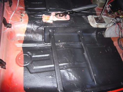

I have just got myself a pair of OMP HTC bucket seats and some side mounts. The previous owner of my shell has already re-eforced it to take some other seats but my side mounts are not of the right dimensions to fit these. Here is what i have already:

depends how capable you are, or how capably your welder is, I'd be removing all the original and added in stuff pictured and fitting something like this -
http://cgi.ebay.co.uk/Weld-in-Seat-Mountin...=item439bb8e3f0
on the drivers side i'd probably cut the tunnel in a little too to allow the seat to sit central and lower.

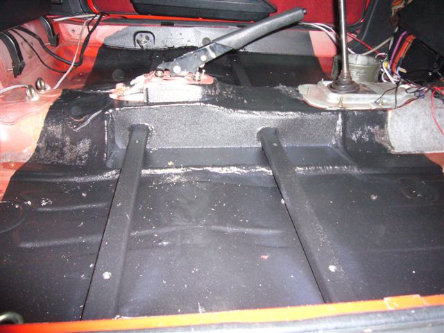

hope these will help ;)
Atari Boy

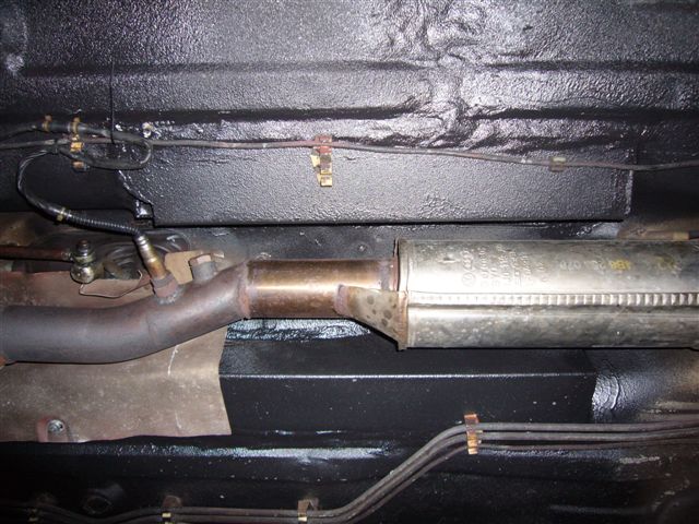

I have done mine very similar to engine killers (I think I even used photos of his set up as a template :) ). I am 6’1” so needed to get as low as I could, which I did. The only problem I encountered which I had not factored in is that I no longer had room for the standard exhaust middle box (I did try and lower it but it kept grounding out) so I had to fit a Cherry Bomb silencer instead.
Don't worry, I copy the method from some senior members here too :)
You can see that I am actually using a smaller diameter mid-box from an Audi RS6 (one of two). I think it's a little larger and lighter than a Cherry Bomb iirc.

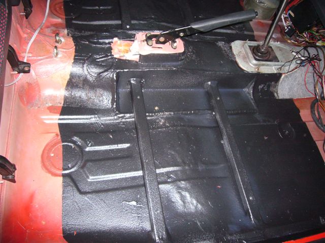

By the way, will flat steel plate for seat mounting be a bit risky?

Some more examples..
