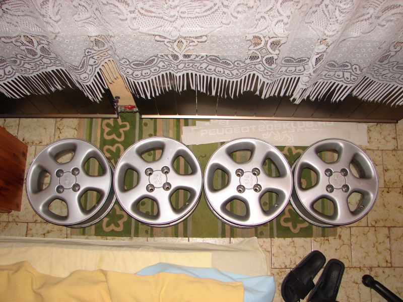

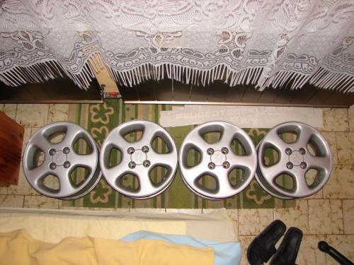

Because the Xsara rear hubs widen the rear I had to say goodbye to my Gutmann alloys and bought these(306 Laser/405 LeMans wheels):

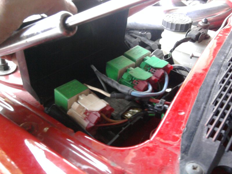

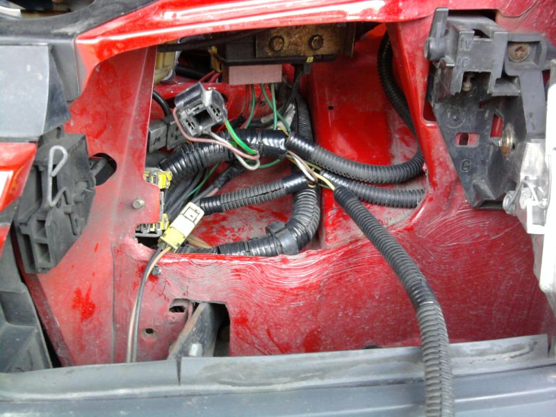

Finally I rewired the whole headlight cables using relays. Now I'm able to drive and see at night B)

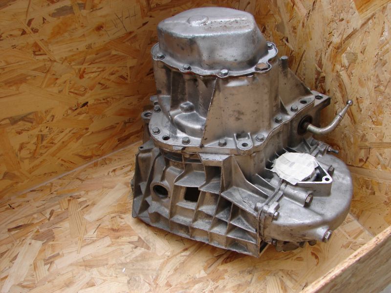

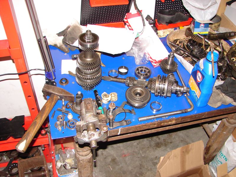

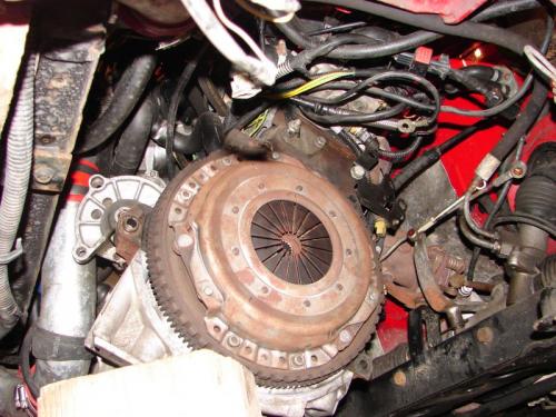

Also i bulit my sanding box to clear my new gearbox housing for the longer gears. Built a hibrid using Mi16 gears and 1.9GTi final drive.

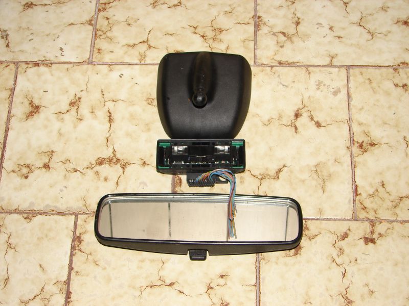

The plan for the near future is to build in the ABS and the rain sensitive wipers from a 306.

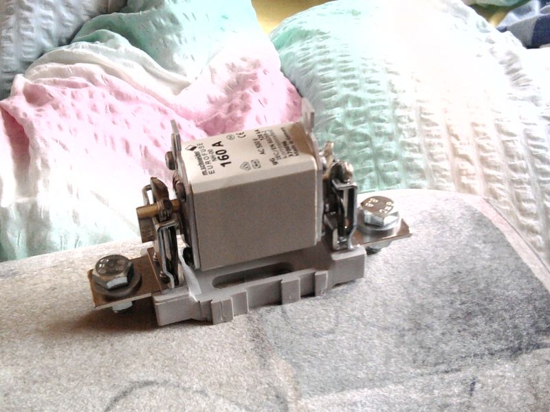

Wiring the battery to the boot and because the A/C gone I thinking about the OE sunroof :ph34r:
A little fuse for the battery :lol:

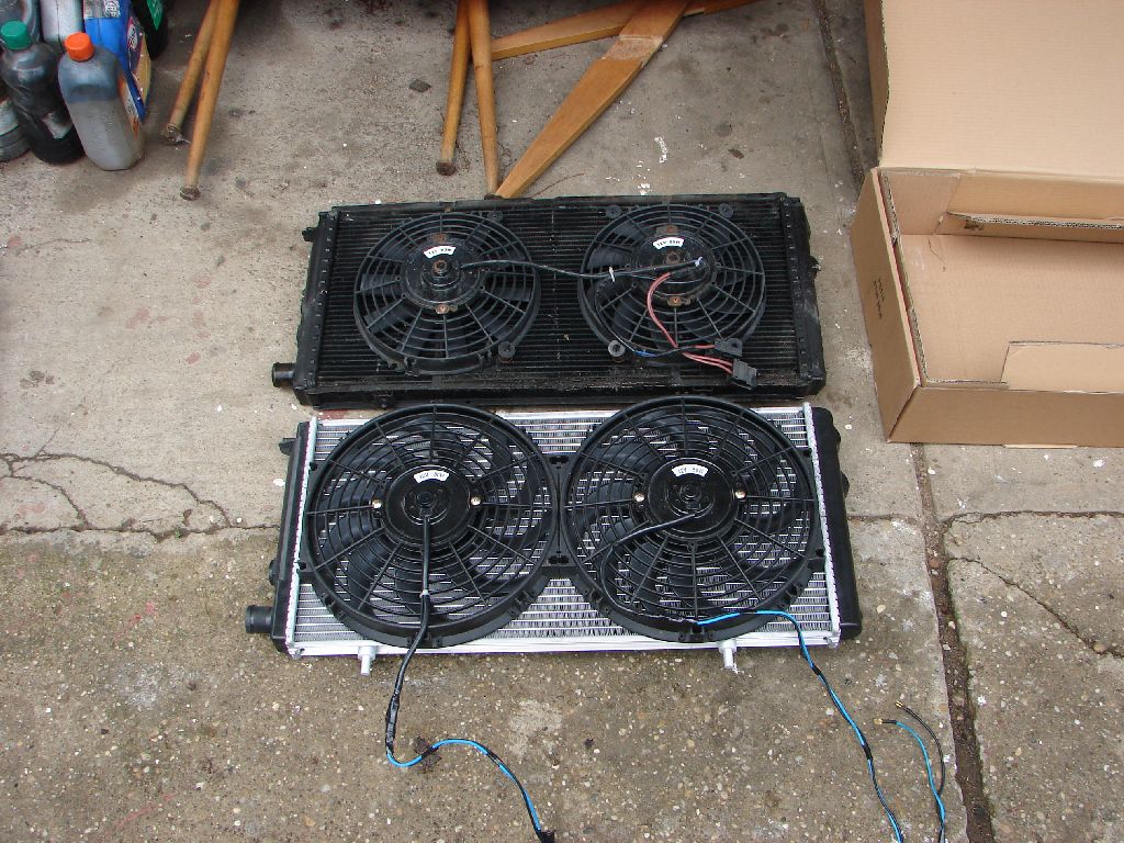

Also changed the rad and the fans for newer, faster, stronger ones :)

allye
What size fans did you use? I'm goin to ditch STD fans soon!
Jamal
It's 11" if I'm right.

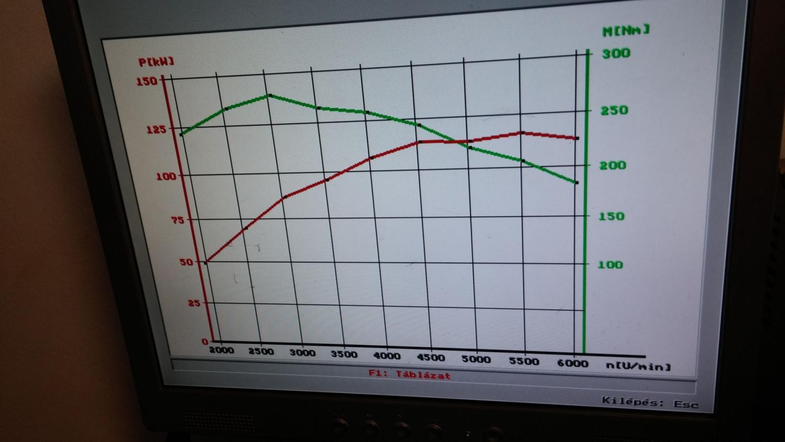

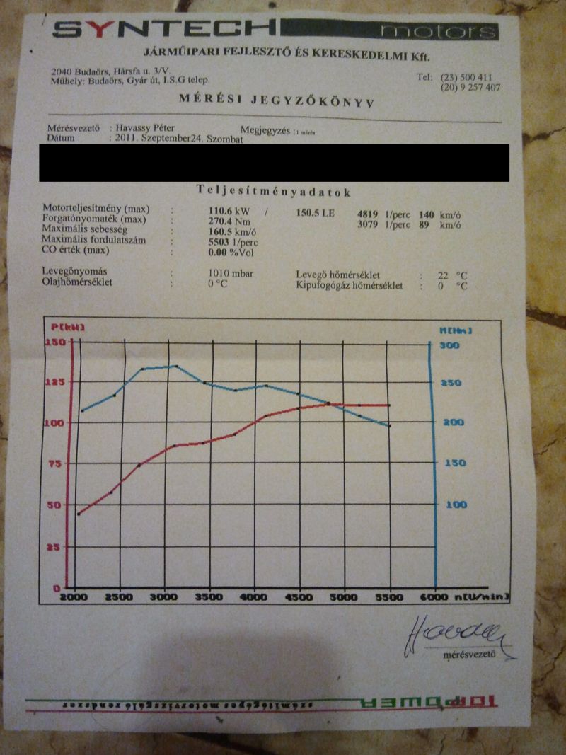

Last weekend I measured the car on a dyno.
Here is the result:
It is a full stock system. Only the wg actuator rod is modified from 0,36 to approx. 0,40 bar.
The overboost is 1 bar, the standard boost is 0,65-0,7 bar.

Now it does 155,2 HP and 288,7 Nm.
Well, I definetly need a DKZ cam :)

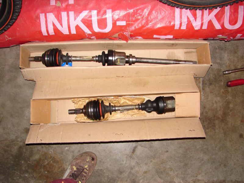

Also changed the lover silent block, because the drivetrain had a strange noise like my driveshafts are on the way to die. But they only done 20.000 kms so I investigated the problem. The silent was dead. I changed and rotated about 90 degrees to be stiffer.
