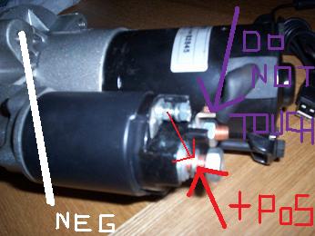

After i talked to the engineer, i was told i should have not connected the small live to the rear connection (in purple arrow in the picture) as
described as the spade connection which looks like a spade shape. What i believe members meant was to connect a small live from the main
positive to the alternator connection bit in red VV. He also advised me to connect the earth from the starter (the white arrow) to the Neg on the
battery, not the gearbox which i can't see why really.

Here's the picture ~ VVV

No, the cog pops out when you turn the ignition key which sends power to the spade connector and it goes back when you release the ignition key when you hear the engine start, its got nothing to do with the alternator at all.

You shouldnt be connecting a live to that spade at all, in fact you shouldnt be connecting anything to it. The only connections you need to make are the ones posted in Davev's picture. And of course stick the negative lead from the battery onto the gearbox.
