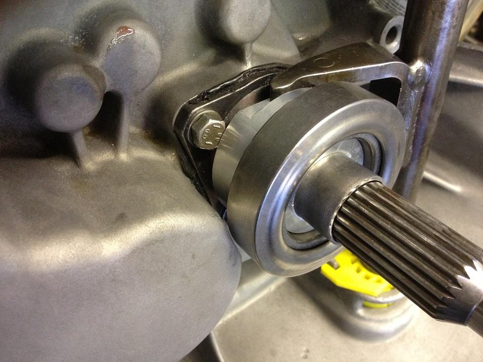

So the Dogbox has been removed after the release bearing problems, i have had the release bearing carrier turned down to fit but with removing the bearing from the carrier for the 2nd time it was becoming a bit questionable as it felt rather lumpy so it was prident to just buy a new one, Tech Craft supplied me with a AP Racing bearing (previously ran a Helix) which proved much bigger than the Helix unit and shock horror it was catching on the casing and so would not go back far enough leaving me still with -2mm of clearence.
After cutting up an old casing to see how thick this section was, about 3.4mm, i got the dremel out and shaved myself some clearence as you will see from the pics below.
So anyone ever fitting a AP Racing Release Bearing can rest assured you have enough meat to shave some clearence for the bearing.
Then unfortunately the carrier sat back against the guide shaft bolt heads so the dremel came out again to shave into the carrier the clear the bolt heads.....
Now all is fitted back and i have plenty of clearence for the release bearing to the clutch.
Must say that was A LOT of hassle but i know everything has been done properly with new parts and should never have to come back out again (touch wood)
