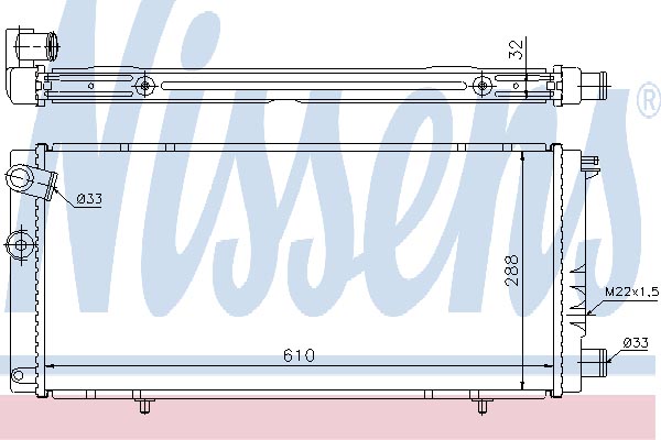

wardy18
Please see the pics, both are Nissens Rads, the first is 205 without Air Con and is the rad i have always known for a 205. The second is With Air Con and seems to have its own header tank built in so would hold much more water in the rad and able to be filled.
Has anyone ever fitted the 2nd Air Con rad and removed the std header tank and just used the rad as a header tank because it has the filler cap and holds the extra water?!

Personally I think it's better to have the header tank separate to the radiator. I'm sure there must be less chance of air bubbles with a separate one.
Maybe if you're looking to save weight and reduce your coolant volume, you could get a nice little aluminium one in place of the large standard one? That is if you haven't already! :lol:

I have the later model black header tank which is the smallest as std was just wondering if anyone had taken advantage of the larger volume and filler cap in the Nissens air con rad, seems pointless otherwise!!

I can't figure out why it'd be needed! The only thing I can think of is maybe to make cold filling easier when the thermostat is closed. :wacko:
wardy18
Well looks like ill get myself a Nissens Non Air Con Rad, i think these are even lighter than standard so thats good and i have asked a few companies for weights of their header tanks to compare to standard but i am not going to spend a fortune on a header tank as i dont see the point so if i can spend maybe 40quid and save a couple of kgs i will but anymore then i wont bother just yet!!
Whats the smallest size header tank i could get away with, am unsure of the std volume but am thinking must be 2 ltrs, i have seen a header tank for 0.5ltrs :blink:

.5L will be fine.
It will have an overflow so will find its own level, just make sure you run it up when first fitting, get it nice and hot (not too hot obviously). Will kick out any excess and when its cool you have your level!
