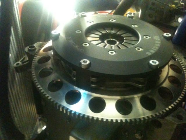

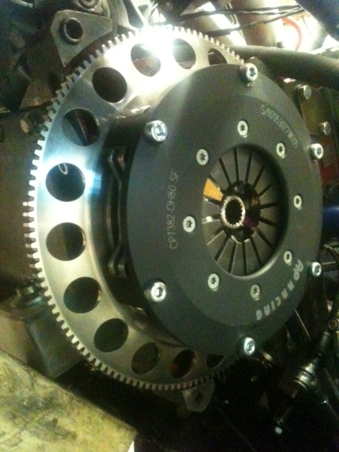

New TTV Flywheel is now fited along with the 184mm AP Racing Twin Plate Clutch

When fitting the new twin plate clutch i was warned about the inner drive plate splines fouling on the crank end due to running the twin plates flush side back to back and so the protruding splines on the inner plate were facing the end of the crank, well i check this and had plenty of clearence so happy days got it all fitted back and fired up for the first time last nite.
All i was greeted with was a very loud screech when clutch disengaged and the car struggled to even start as if something was binding plus i had no gears at all.

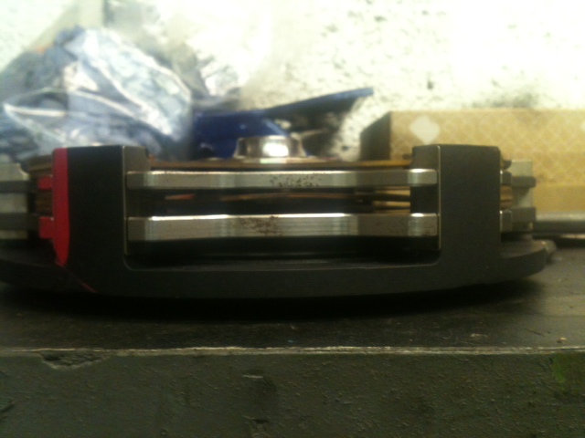

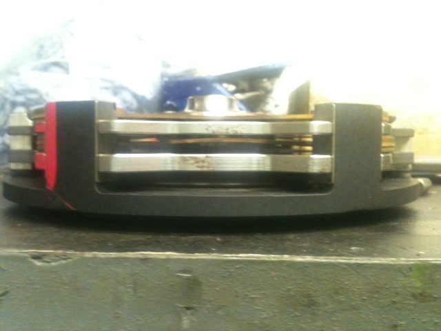

It appears it was totally the opposite end of the clutch that was fouling which i found strange i was never warned about. The shaft which the release bearing slides back forwards over has fouled on the protruding splines of the outer drive plate, when i lifted the box up it didnt slide straight on but i thought it was just stuck on the 2 dowels so put the gearbox bolts in and pulled the box in with them at which point i would have been bending this drive plate inwards towards the back of the inner plate. (see pics)
Now i have thoroughly check the drive plate and it has bent inwards perfectly symetrically and so wont wobble when in place, it has bent inwards says 3mm and in so doing pulled the 3 pads inwards by about 0.5mm each but they still lie percectly flat on the diaphram plate because as it was being bent the pads were clamped by the clutch housing. so all i need to to do is shave down the release bearing shaft a little and shave down teh protruding splines on the outer plate and refit but i am going to confirm this is safe to refit first as i dont want it to crap out at all on me.

I know it's probably not what you want to hear but if it were me I would replace that drive plate. Considering the stresses evethything is under at high engine rpm I wouldn't feel comfortable having what is effectively a weakened clutch plate, the £120-ish that it'll cost you to replace is surely better than the thing s*itting itself all over your nice clutch cover, flywheel, and the inside of the bellhousing!

can you get it in a press to straighten it back out?

I fear that pressing it flat again will just start to buckle it and would distort the pads, dont know how i would hold the pads down flat while pressing the centre back down
only solution is to get another and make sure it fits, or re-fit the original clutch?

Just phoned AP Technical and explained what's happened and they said as long as ALL the paddles still lie perfectly flat on a flat surface then there's no problem, the only issue would be if a paddle has lifted and so doesn't lie flat so the "run off" would be out between the 3 paddles.
As the paddle was pressurised between the pressure plates the paddles still lie perfectly flat so it will be fine to keep using.

I would also check very carefully for damage to the pad material or signs that it's lifted off the plate whe it's been bent. For the potential damage it could cause it's just not worth the risk in my opinion!
