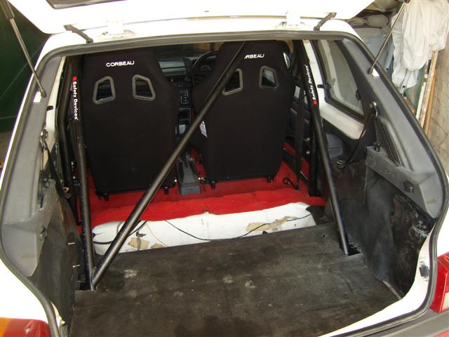

i have an SD cage,
all wrapped up
test build out of the car
Baz's pictures are best for the welded in ones as i dont have any of mine prior to apinting the welds etc.
including the welding etc i think it took me 3 hours to get it in and sorted with a mates help, bearing in mind that was the first time i'd ever put one in. i took it out to spray all the welds etc and when i put it back in it took about 30 mins on my own. sovery simple once you've got the base plates in.

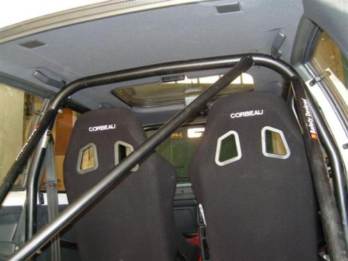

timb1046
and heres one i found of it in the car from the rear, appoligies for the state of the rest of the car :blush:;)

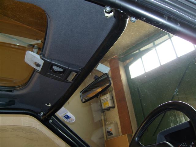

MrG
here's mine installed
MrG
I've kept the seat belts as they're easier to drive to and from the track with and these pics don't show the harness fitted, but you can see how close it is to the sunroof.
