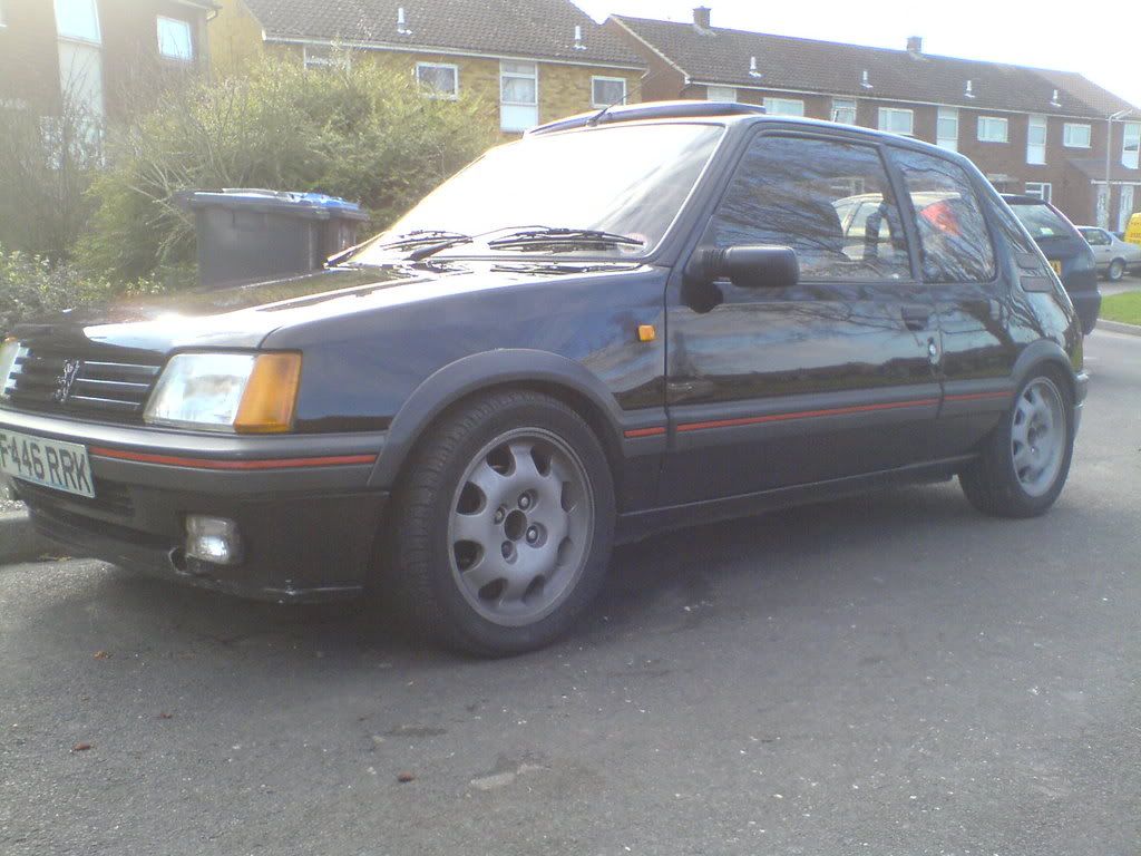

NeilGTi85
This is what 60mm look's like:
Thats to low for me & the picture of the car I mention looks nowhere near that low.

Dazza
I know Kieth and he still has the old 205 .....
60mm drop not for me either , mines about 50mm and its bob-on
