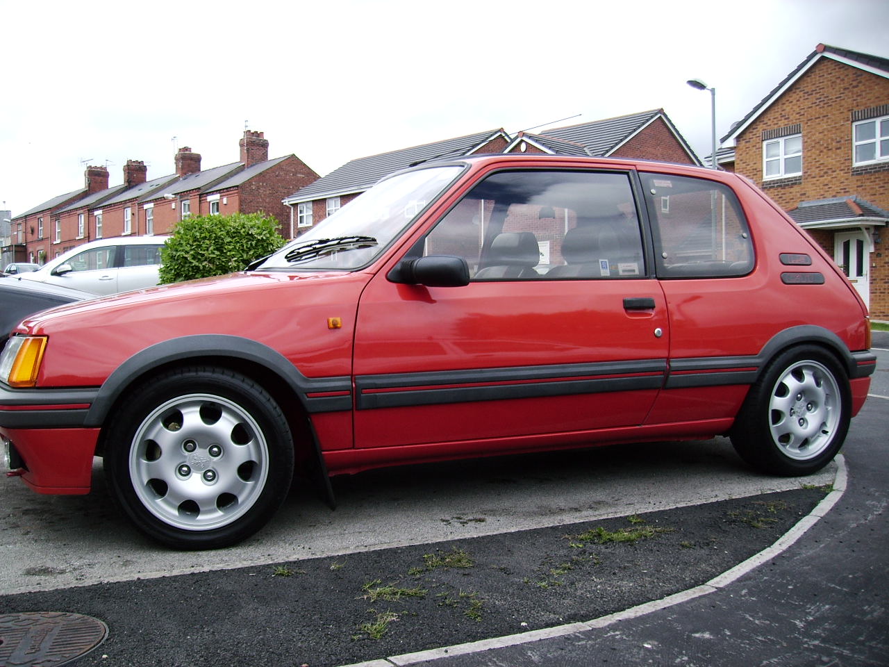

as i fitted a 309 beam to my 205 gti which had 195/50/15s fitted, and it never scrubbed when i had 2 spare 309 axles in the back
pic is of how the car sat normally
