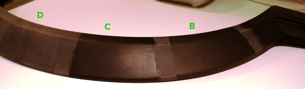

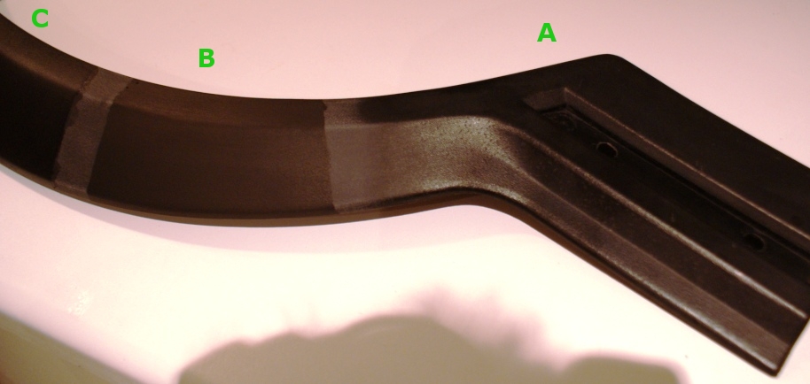

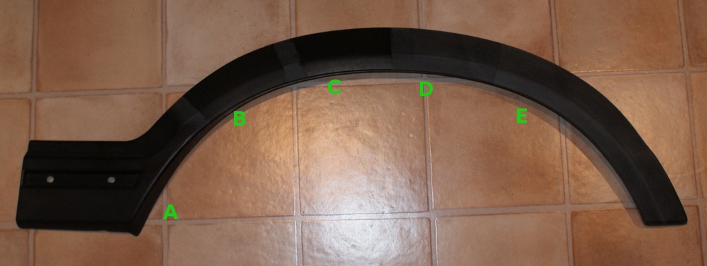

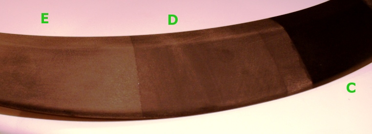

Got some pictures of one of my arches in various stages. I'll be doing my spoiler eventually so I'll update it on here when it's done.
So, the following pictures show an arch that I've masked in to sections. I think it must have been a Ph1.5 grey arch originally.
Sections:
A - A bit that was previously painted (done before my ownership) black
B - Cleaned back (as per section E) and treated with a single coat of black Plasticare. Like this is has a really nice matt texture.
C - As above, but finished with Autoglym Bumper Care (aka bumper snot). This gives it a shine.
D - As per section E, but cleaned with panel wipe. This seems to darken the grey a little. Dunno why (and yes, it was dry).
E - Old paint removed with scotch pad. Not sure if this is what the plastic would have looked like originally or if it's perhaps a lighter lighter due to being attacked with the scotch pad.
Can anyone please confirm if the images are clear or if they are pixelated? My T-Mobile connection compresses images, so I see them as being slightly pixelated, but I'm not sure if they will have uploaded in a compressed state as well.

EdCherry
Clear
