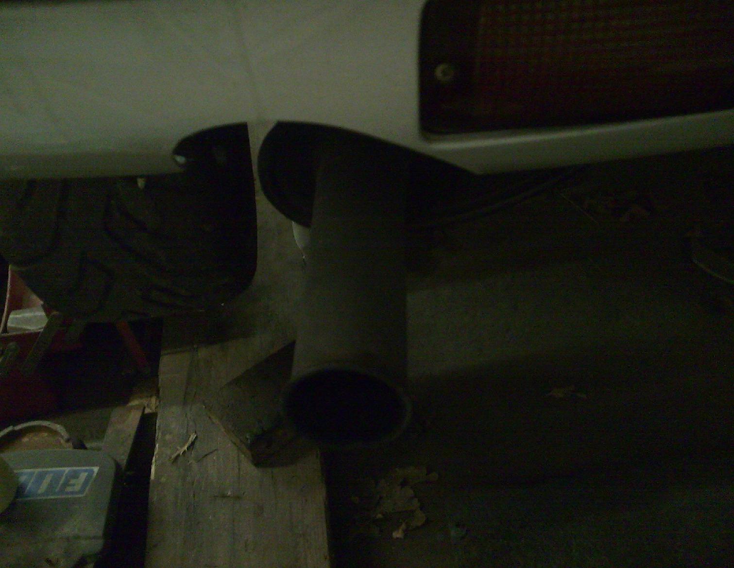

I also fitted the exhaust that arrived last week but i think it's going back where it came from becuase as you can see it looks rediculous and doesnt fit at all:

where did you get the wonky exhaust from, shame it doesn't fit right hopefully thats a one off
burr_2000
hey mark thats not the back box they supplied me, that looks like a normal sports backbox because of the chrome. my one is really plane. i can try get a photo up.
swordfish210
Thanks, please do so i can e-mail them to show what i actually wanted.
Batfink
that looks more like where a gti exhaust would hang. Still looks too low even for that. Hanger rubber mounts ok?
Yeah the hangers are good quality Poly ones. I did think GTi exhaust but as you said, it still looks hideously low. I can't imagine riding the kerbs at Llandow with that exhaust, it would come clean off :wub:

i have quickly taken a pic of what back box they supplied last year.
swordfish210
Lovely job mate, i'll get on the blower to them tomorrow.
swordfish210
I spoke to the exhaust place today it turns out that yours Neil was a one off they made and they reckon it's supposed to hang down that low :) I'm going to send mine back and get another but if it still hangs that low then methinks i'll be modifying the hangers quite a bit. Nothings bloody simple is it.
