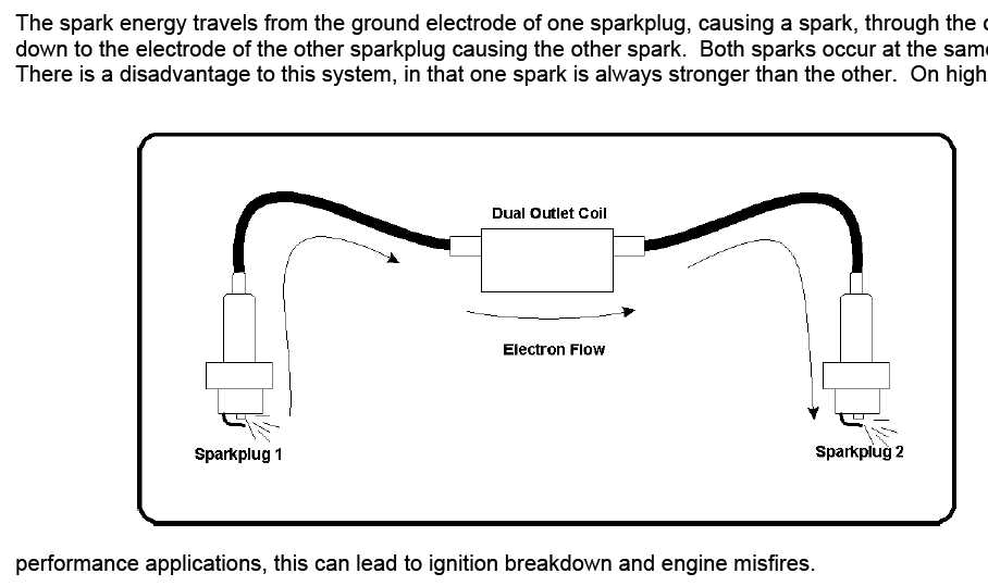

Coil-wise i have and everyone seems to use an Xu10 wasted spark type affair.
I picked this up from the XU section. Not everyone runs wasted spark. Certainly not myself or DrSarty. Wasted spark fires two plugs at once. This means the current flows from one plug to the other. Thus only one has optimum spark. I run four individual coils fired by a four channel CDI. Richard runs four LS1 coils, which while they fire in pairs, have individual internal ignitiors.

Thus the centre electrode of one plug will be positive, the other negative. At least that's how I see it. Anyone else?

indeed you are correct in your assumptions. It is much better to use COPs in a wasted spark mode, than the double coil setup.
The current in a wasted spark systems rungs as on the diagram in the first post, and one of the sparks is always getting a worse spark.

The wasted spark system does indeed have one spark weaker than the other, but the weaker spark is always the wasted one.
When 2 cylinders are at TDC one is on compression/power stroke the other exhaust/inlet, so one cylinder has a compressed wall of mixture to pass the spark through the other doesn't. The amount of energy available to jump the gap is shared, but not equal so the wasted spark is weaker, but on the next cycle it will be stronger, and so on.
Modern ign systems have plenty of spark energy to do this, but problems can arise with high boost turbo engines as the spark energy required increases as the pressures in the cylinder increase.
Wasted spark systems can reduce emissions by burning any fuel left in the cylinder on the exhaust stroke, have less output channels (cheaper) and less wiring. This makes them attractive to OEM's.

I was also thinking about that, the coil is always charged in one direction electrically, therefor the coil core is always charged magnetically in ONE direction before it uncharged in...the other direction.
That means that the uncharge direction will always be the same unless there´s a "little monkey" that swithces the cables around every other spark, or switches the charge polarity every other spark. To my knowledge these very basic and simple systems, always has the same polarity on the charge.

Your right about the "easiest path" always being on the exhaust spark, couldn´t be any other way really since it takes a lot to "spark" in the compressed A/F mixture. But that only makes the plug in the exhaust cylinder a very easy path to just pass through so it doesn´t rellay do much to weaken the spark ini the compression cylinder, some yes, of course....., but not a whole lot. Unless you´re running a overcharged engine on ehtanol or something like that :blush:, that takes SERIOUS spark-energy to work good.
