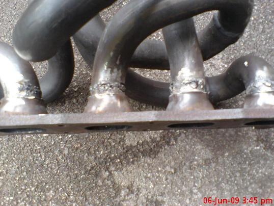

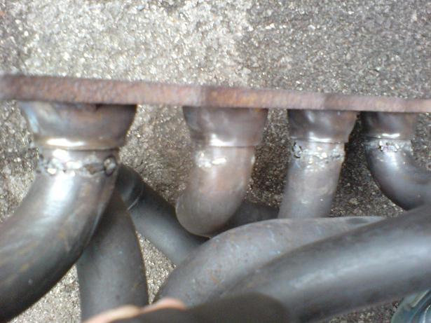

Below should be a couple of photos (phone only, so quality not very good) but hopefully it gives you an idea. The black circles are where I've marked some of the "pin holes" with a marker pen.
Those welds looks like they have been done by someone who just can't weld.
If you use the MiG the correct way it's no problem to get proper burn in dept and nice looking welds, not to mention leaks..
That's surely not the MiG's fault but the welder <_<
Unfortunately it looks like your mate has good intentions in trying to help you, but his welding isn't really up to it.

Unfortunately, I think you may be right! Thanks for your honest opinions :P I think I will test fit it tomorrow morning again, make sure it's still at the correct angle. And then get it done properly :)

i would cut that back off grind off all the weld and start again.

Deffinatly looks like bird s*it, find another mate...

Ok, welds are not pretty indeed.
However, that isn't necessarily down to poor welding skills.
From personal experience, carbon deposits from exhaust gasses on used manifolds can cause big trouble, even if the welding kit is set properly.
I would follow the advice of cutting the welds and starting again after giving the insides a good clean with a wire brush.

It can cause trouble, but with a MIG you won't end up with dog vomit like that unless you don't know what you're doing.
That's surely not the MiG's fault but the welder :rolleyes:
+1.
Ive MIG welded a few of these now, and they actually weld up very nicely if the welder is set right.
