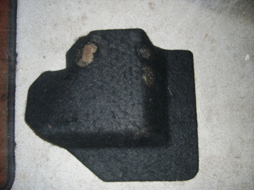

Can anyone kindly tell me how this panel is supposed to attach up under the dash in the fan area. It keeps falling down like it did on my previous 205, although this time I'm not going to throw it in the boot and forget about it for the next 6 years :ph34r:

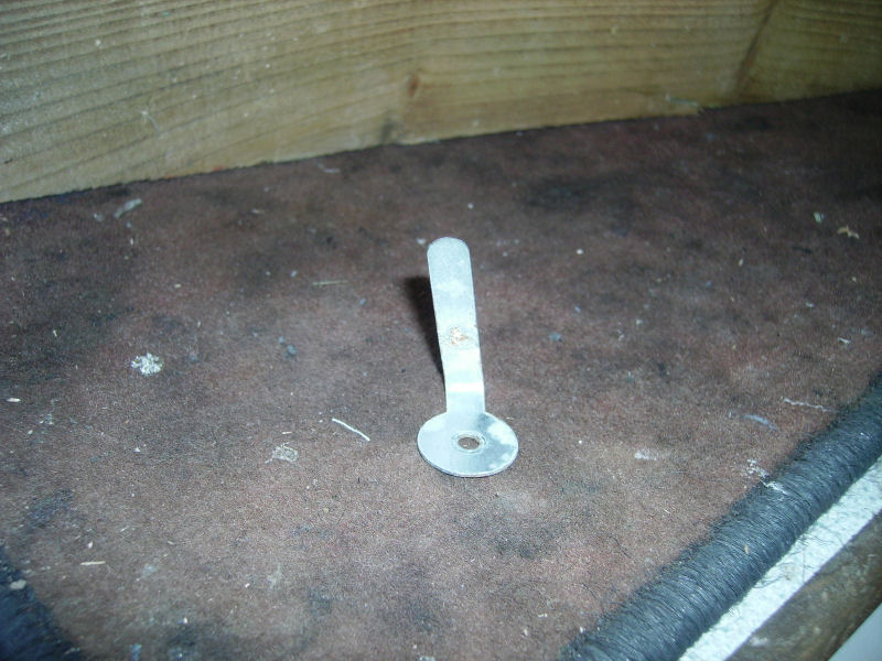

Whilst having a forage around the scrappy for various goodies I thought I'd investigate another 205 heater panel. I've now found out why mine (on both cars) would never stay up - the missing clip!! Obviously someones had the fan out of this car and never put the clip back on, job's good now though.
