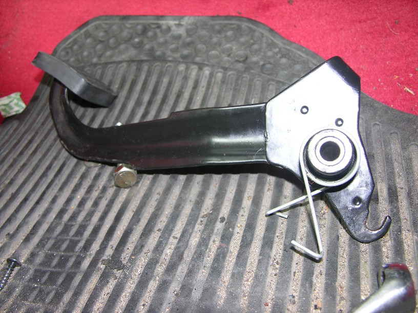

I took off my clutch pedal to fit a new cable and now cant remember how the spring goes back on; I have tried but got it wrong and cant figure it out :lol:

I think I have figured out that one side of the spring goes under the pedal (as shown) and that the other side attaches to the fixed parts of the pedal box somewhere, but where?
If you can get a pic of the actual box I can point it out, the spring hooks round the pedal, then the other end locates in a small hole on the pedal box frame.

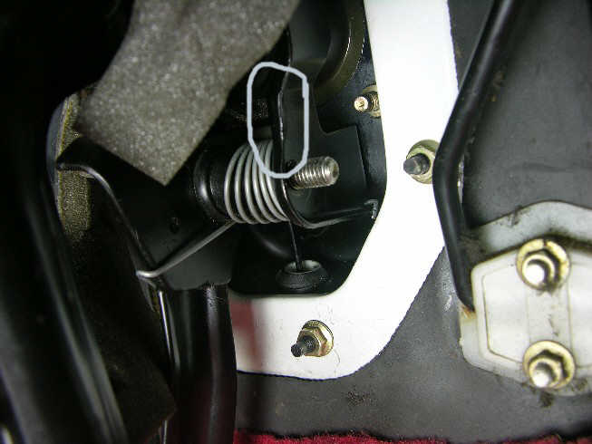

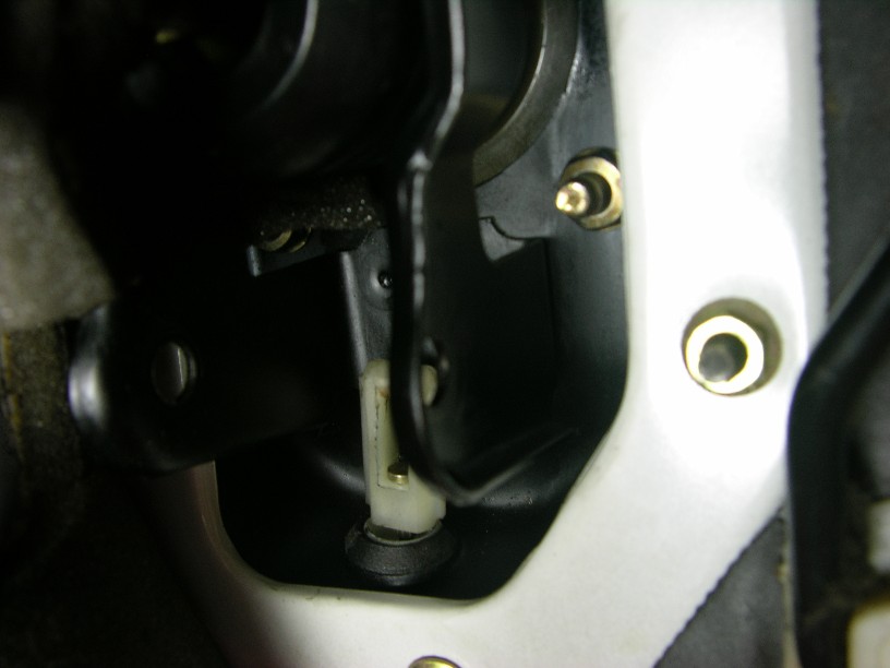

The hole is in the corner of the bracket the pedal bolts through, the rounded end of the spring goes on the pedal, the more square end hooks through that hole.
Grim.Badger
Like this?

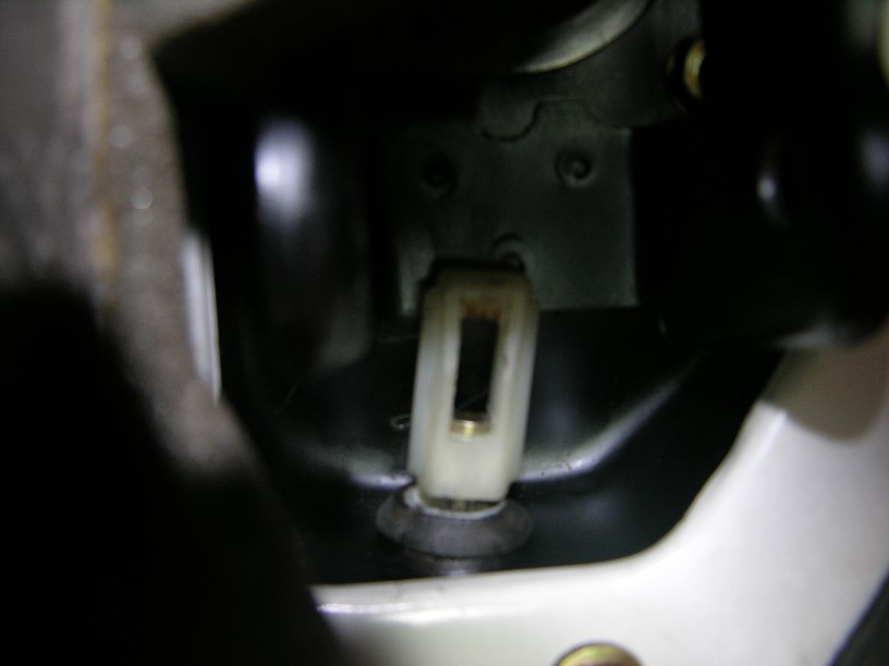

If this is right I think I have messed up with the clutch as when I try to adjust the cable the pedal doesn't lift; all that happens is that the clutch arm moves :(

that picture is correct

Like this?
No, the spring thats under the pedal box should be in the middle above the bolt, you can see where the paint is marked from it being there previously.
The pedal is normally sat on the floor due to the spring tension when its fitted but pulling the cable @ the gearbox end towards the radiator should lift the pedal even if the release bearing has fallen off imo.
