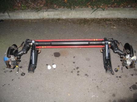

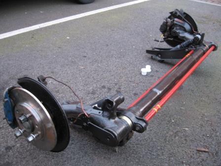

Hi all,
Now I have finished painting my freshly refurbed 309 Gti beam :D , I am seriously pleased with myself!
(Thanks to Anthony for the refurb)
However, as usual, there are a couple of things confusing me :P :

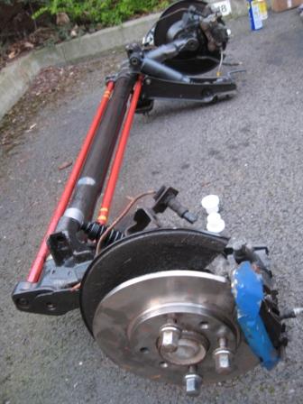

1) When the beam is fitted on the car, which way do the new K6 shockers go, is it with squashy black plastic/rubber protector pointing down towards the ground, or with the squashy plastic gaitor protector thing pointing upwards towards the body of the car (please bear in mind the beam is upside down in the piccies), also,
2) What the hell are the white polyeurathene bushes for that came from my BBM Group A rear beam mounts? Where do they fit?
Chris
oli-pug
The damper gaiters are at the top when on the car. The bolts are different sizes anyway so will be obvious.
The bushes are for the front mounts.

Dampers go gaitor up and the white top hats replace the rubber bush - where the fwd mount with the two studs that bolts to the boot floor attaches to the beam. Remove the single nut and bolt, pull of the mount and you will see it.

That looks like a right job! So, let me get this straight, do the white bushes actually fit anywhere on the beam in my photos? Is it underneath the pan type thing with two bolts sticking out, on either side of the beam (i.e. the part touching the floor in the pics). Or when I lift the car up will I find them (the old bushes) hidden underneath the car somewhere?
BTW, I did get 4 :ph34r:
Is it worth actually going through the bother of fitting these? I've already replaced the rubber sandwich with the solid metal block, but will these PE bushes make much difference?
Thanks once again, and apologies for my stupidity. I searched for front mount, but mainly came up with front strut topics.

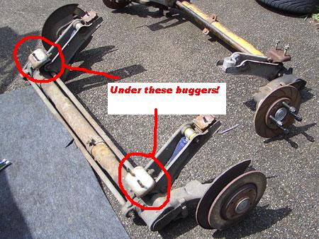

Hope this makes sense.
Rupertfinch
In fact - this should help even more. It confused the hell out of me when I was working on my beam!
Image stolen from main forum - jonmurgie's rear beam guide. Have a look.

This topic covers removing & refitting them pretty well & indepth & this picture from the linked topic shows how I did it easily.
