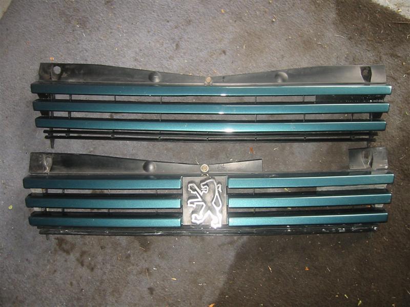

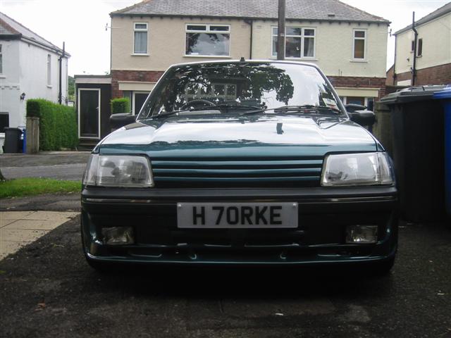

Iv just made one,it used two grills cut the badge out,and cut the bars from the other grill to fill the gaps,plastic welded them in,a bit of filler,loads of sanding,prime and paint,job done,will post pics tomorrow if i get time.
I also ordered one from dijnuk but the divvy royal mail wrecked it by the time it got to me,this one was made different,the badge was taken off and the gaps were filled with filler and shaped into the bars,the only thing with this way is you can still see where the badge was between the bars.

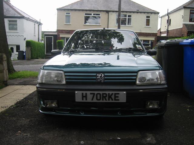

Or hand the german company Mattig £40 and a couple of days later you will recive an awsome grill made from the same rubbery material as spoilers.
This is mine

Heres the pics of mine,i done it at last,i think i was pretty late though, :wub:
omega
Heres the pics of mine,i done it at last,i think i was pretty late though, B)
looks very nice
