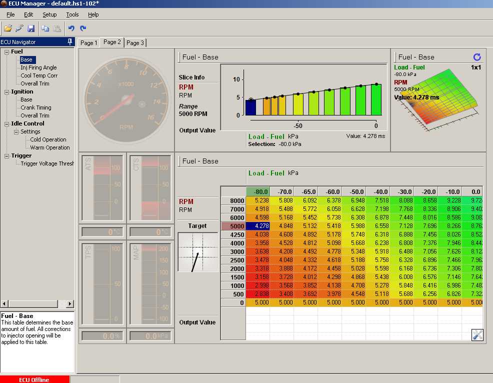

How would something like the Haltex E6x compare to the ones mentioned in the thread?
The E6X is quite old now but still great value. Haltech have a new model called a Platinum 1000. It's a huge leap forward, with more advanced features (like Autronic SMC) for only a few hundred more. I've only just taken delivery of one, but looks very impressive for the $$$.
I've triggered XU10J4R coil packs via a twin channel CDI. Very impressive results. So smooooth. You also can pull a plug adaptor off and fit a lead to cyl. #4 in order to check the base timing.
Notice in the fuel map below I've added a 4250 RPM row. You can add/subtract rows & columns as required. Another nice feature is the ability to map the fuel via TPS and the ignition vai MAP. A great feature for big cams and TB's.
