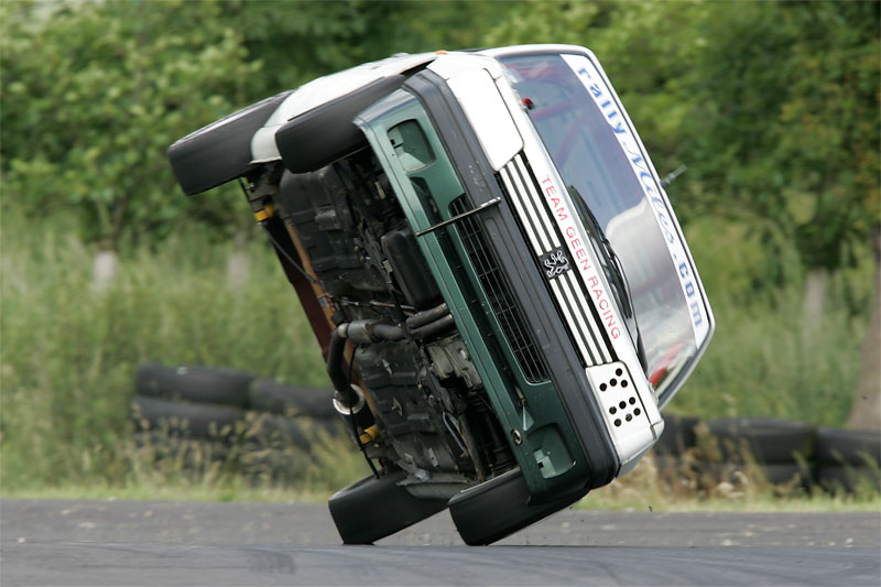

Be careful with stickier rubber though, if your suspension setup's not up to it, there can be an adverse effect to having lots more grip - bodyroll, literally the whole car rolling... ;)
And even when the suspension IS up to it if you take too much kerb!
That's an "oh s**t" moment if ever I saw one - good work by the photographer though! ;)
