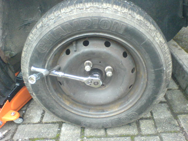

Stumbled on this method recently - removes the nut a doddle :lol:
Obviously the staking must be released first, I just tap a screwdriver bit between the nut and the groove in the shaft end, then...

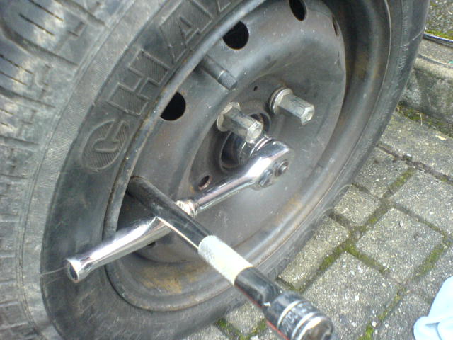

Fit a steel wheel like this and position tools thus
Pull the ratchet upwards as far as possible against the extension bar, then pull down on the end of the bar.Doesn't actually need a lot of force You don't get a lot of movement, but repeat 2 or 3 times and it should be free enough to undo with the ratchet alone - easy!! B)

interesting, but is this really making it easier than a decent length breaker bar? ;) I can see you won't have the problem of the wheel turning, but I'm not sure if you can apply the same amount of force?
I have had trouble taking hub nuts off that have been done up tight with an air gun, wondering if this would of worked?

It appears a LOT easier than a 3' breaker, and a nut that withstood a normal T-bar and 5lb lump hammer came off with less force than it usually takes to undo a wheelnut with an X brace, but I still wish I had a windy gun :wacko:
Any one with a better memory / understanding of a double fulcrum principles (or something like that ) in physics like to work it out?
Edited by steve@cornwall
rough estimations show it as doubling the force, which would place the length of the lever roughly the same as a decent breaker bar, but its rather easier to stand on the extension bar poking out of the wheel than a breaker bar.

thats not really what a ratchet was designed for, could quite easily damage the teeth ;)
breaker bar would be a better option imo

Steel wheel + breaker bar + 6ft scaffolding pole always works for me :)

I just stand on the end of the ratchet, don't even bother un-peening the nut, I'm not a little fella tho!
C_W
Yes normally the squashe bit of the nut will just unssquash when the right amount of force is put on it to undo the nut. In the past I've snapped 1/2" drive tools undoing my hubnuts, 3/4" stuff makes it much easier (still with a bit of an extension on it though).
