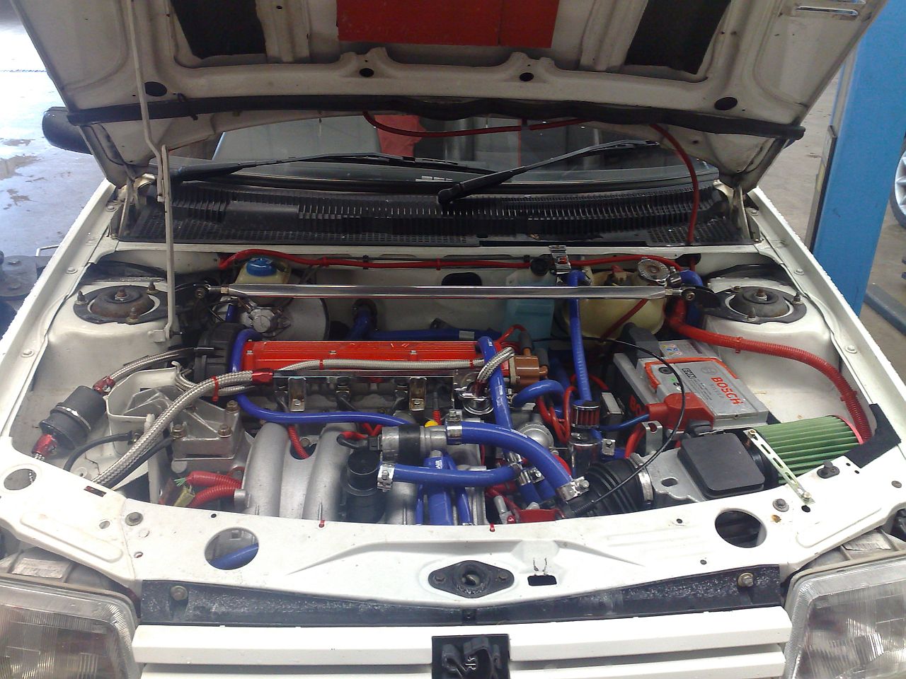

Rom
Ive used a 309 rear washer bottle on mine.
Although you can keep the standard one and move it to the OS wing, where the jack goes. My car never had a jack though, and my washer bottle lid was fubar.
Plus i wanted to move my fuel filter, so i went for a small bottle on the bulkhead.
My airfilter is pretty big, and ive got AFM mounted flat, and i just about manage to cram it in :unsure: Using a 405 inlet pipe. The BX ones are a lot bigger i think.

Its a rear bottle from a 309, dont know if all models have them.
Theres plenty of ways round it. This is just what i ended up doing.
